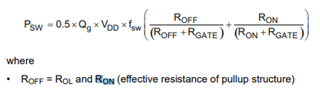

I would like to use the SON-8 version of this device due to its smaller size, but I need to make sure it's capable of handling the gate-drive power loss. I understand that the total Ploss = Qg*Vdd*Fsw and that this loss is then proportional to the size of the resistor in the gate-drive path. For turn-off it's clear to me, but for turn-on, I don't know what the equivalent turn on resistance is for the UCC27614 due to the NFET and PFET structure. The datasheet mentions an "Ron" but I didn't see it referenced anywhere else in the datasheet.
