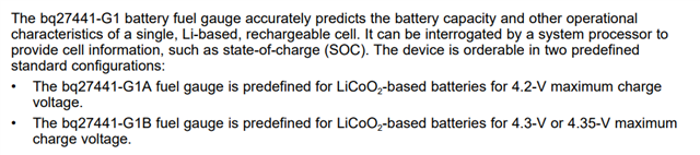

Hi I am using the fuel gauge BQ27441 with the Li-ion Polymer Battery UFX 605080.
The fuel gauge often reports the incorrect current capacity, full capacity and the SOC.
Even after training the learning cycle and obtaining the parameters, writing it to the i2C library, same behaviour is observed.
Am I using the correct type of fuel gauge with the battery with the appropriate fuel gauge ?
