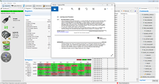

Hello, I am proceeding through the Learning Cycle illustrated by the diagram in Figure 11-2 on pg. 65 of the BQ34Z100-R2 Technical Reference Manual.

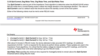

I got VOK = 0 and Update Status = 0, but RUP_DIS is set high despite me having left the device with no current flowing out of the battery overnight, which to my understanding is supposed to cause the device to enter RELAX mode after a while and take a VOC measurement which is supposed to cause the RUP_DIS register to drop to a 0.
I came across this post BQ34Z100-G1: bq34z100-G1 question: should RUP_DIS be clear after applying a golden image? - Power management forum - Power management - TI E2E support forums that said that "For the initial discharge, you want RUP_DIS = 1 so resistance updates do not occur" and contains a link to a file that seems to say the same thing: /cfs-file/__key/communityserver-discussions-components-files/196/4722.LearningCycleOverview_5F00_.pdf This seems to contradict the recommendation in Figure 11-2 of the Manual that RUP_DIS = 0.
I've been running through the discharge cycle despite RUP-DIS being 1, should I keep running through the Learn Cycle or do I need to do something to reset the RUP_DIS register to 0?

    Please follow the steps in this document for the learning cycle: Achieving The Successful Learning Cycle (tij.co.jp)
    Please allow make sure all parameters mentioned at the beginning of the document are properly configured before beginning the learning cycle process.

    The instructions you sent seem to mention talk about GAUGE_EN command and register. I don't seem to have these.
    Should I try IT_ENABLE before I go through the discharge cycle? Do I need to do IT_ENABLE and then RESET? Will IT_ENABLE make any changes I can't undo? Will RESET erase everything and make me have to reenter all the values I put into the registers?
    Yes, for this gauge send the IT enable command.
    I would like to mention I would avoid sending reset commands during the learning cycle process.
    Diego
  • a reset cmd will not reset df parameters
  • Ok, because the Figure 11-2 diagram says you use the IT enable command after discharging it, but if I can't get RUP_DIS = 0 then I need to figure out how to get it to be 0 before I discharge it, and then after discharging it I can then consider the IT enable command, correct?
    Or would IT enable activate the Impedance Track algorithm and then it'll go into relax mode and set RUP_DIS = 0 as part of that?
    IT_EN will enable the Impedance track algorithm, discharge to empty then enable IT.
    Diego
  • Tried that last night and it worked, thanks! One more question-- what happened to Evan? Or was there never any Evan, just as Oceanaia was always at war with Eastasia?
