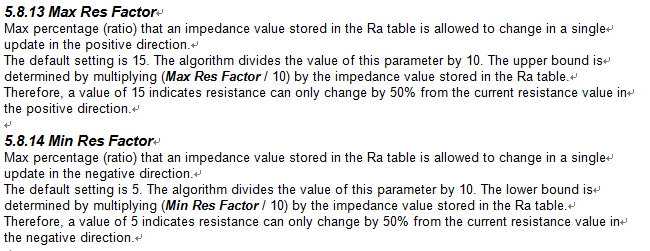

BQ34Z100-G1: About BQ34Z100-G1, I want to limit the Ra table increase by a big margin after learning.What parameters do I need to modify.And,why the Ra table will update abnormally in the customer market.
Part Number: BQ34Z100-G1
Other Parts Discussed in Thread: GPCCHEM
Recently, we have received market feedback regarding abnormal Ra table.SOC and FCC from 100 jump to 0 when charge in the end.
The battery(4S3P) capacity is about 15000mAh. The learning status is 06 before pack produce.The information as follows.
Gas Gauging State Qmax Cell 0 15317 mAmpHr
Gas Gauging State Cycle Count 0 num
Gas Gauging State Update Status 6 num
The Ra table abnormal when cycles is 14.
Data Cycle Count 14 Count
Ra limit remains at default settings.
IT Cfg Max Res Factor 50 num
IT Cfg Min Res Factor 1 num
IT Cfg Ra Filter 500 num
IT Cfg Ra Max Delta 15 %
The limit of Ra variation is 1.5 times.By comparing R_a0 and R_a0x, the update amplitude has exceeded 7 times.
