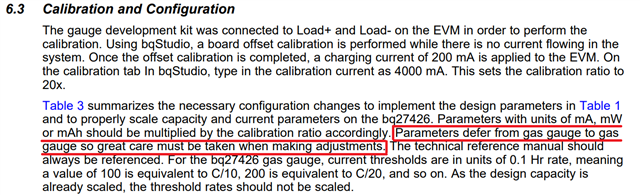

 And, following the application note (SLUA792) we set the design capacity to 8000mAh for a 400mAh battery.
 We tried the current calibration by setting the calibration current value to the actual current value (100mA).

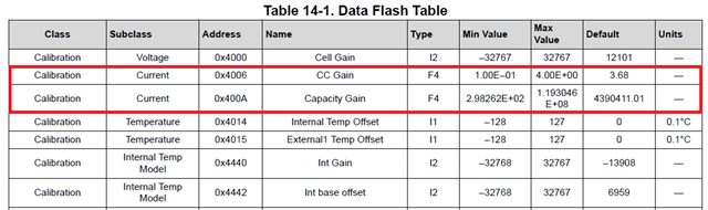

 Result, the CC gain and the Capacity Gain became "20" mOhm.
 Those values are outside the setting range described in the Technical Reference Manual (SLUUC54C).
  Is it okay to use this value ("20" mOhm)?
