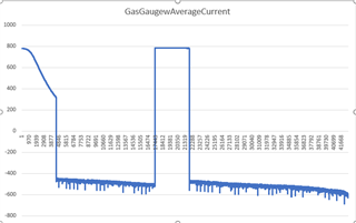

    But now an additional issue has appeared.
    We made a test with charging/discharging to see how good the the SOC will be displayed. This value we use in our application to decide when our device need to be shut down due to the lack of capacity.
    From the picture below you can see that although CellPackVoltage is reaching the value of TerminateVoltage (3V in our case) the SOC value remain blocked at ca. 78%.
    The TrueSOC is going down but not the SOC. Do you have an explanation for this behaviour?

  • Hi Alexandru,
    Regarding the SOC issue, would it be possible to share a log file so we can take a look?
    Anthony

  • Hi Alexandru,
    Thank you for sending the log, I believe that the True SOC is dropping because there is still a discharge current being applied at this time:
    However, regarding the reported SOC, I believe this value is dropping from the constant value to 0 due to the smoothing algorithm, where the gauge will update all of the passed charge in a relax state once exiting the relax state. However, with the discharge still occurring, the gauge should not be in a relax state, in turn the smoothing algorithm should not be active at this time. Can you please tell me what the Quit Current Parameter is currently set as?
    Anthony

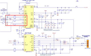

  • Hi Anthony,
    the CE pin of the charger is all the time LOW. (see the attached schematic)
    It is possible that the communication between the charger and gasgauge has been interrupted for a short time and the mode has changed from Host to Default? That could explain why the voltage has chaged to 4200mV (this is the default value in REG04) and the charging has started althogh the FC bit was set. What is your opinion?
    Alexandru Mixich

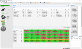

  • Hi Anthony,
    i've provocate a communication error on the I2C lines between charger and gasgauge and i was able to reproduce the issue and confirmed on this way my assumptions written in my last message. To generate this case i've short circuited both communication lines for few seconds.
    Attached the log file taken with bqstudio.
    Wed Sep 11 13:41:52 CEST 2024

    50,2024-09-11 13:50:12,500.379,0x0102,0x029B,0,65535,27.05,4079,0x0728,0x00,4087,4092,4049,4049,0,0,65535,-15,27.95,0,0,3,89,0,100,1,0,0,0,0,0,0x40,0x37,0x5A,0x60,0x00,0x03,0x18,0x1F,0x0F,0x0F,0x0F,0x0F,4500,4598,-2,1344,1320,7,3936,4049,3941,4049,100,1209,SUCCESS
    51,2024-09-11 13:50:24,511.856,0x0102,0x029B,0,65535,27.15,4082,0x0728,0x00,4087,4090,4051,4051,0,0,65535,-15,28.15,0,0,3,89,0,100,1,0,0,0,0,0,0x00,0x37,0x0A,0x60,0x00,0x97,0x18,0x1F,0x0B,0x84,0x00,0x2B,4500,4598,-4,1344,1320,7,3939,4051,3942,4051,100,1185,SUCCESS
    52,2024-09-11 13:50:32,520.408,0x0102,0x029B,0,65535,27.15,4082,0x0728,0x00,4087,4090,4051,4051,0,0,65535,-15,28.15,0,0,3,89,0,100,1,0,0,0,0,0,0x00,0x37,0x0A,0x60,0x00,0x97,0x18,0x1F,0x0B,0x84,0x00,0x2B,4500,4598,-4,1344,1320,7,3939,4051,3942,4051,100,1210,SUCCESS
    53,2024-09-11 13:50:44,531.879,0x0102,0x028B,0,65535,26.75,4189,0x0728,0x00,4086,4089,4051,4051,567,2375,65535,-15,28.25,0,0,3,89,0,100,566,0,0,0,0,0,0x40,0x37,0x1A,0x60,0x00,0xB3,0x18,0x1F,0x0B,0xA4,0x00,0x2B,4500,4598,-4,1344,1320,7,3941,4051,3944,4051,100,1191,SUCCESS
    54,2024-09-11 13:50:52,540.429,0x0102,0x028B,0,65535,27.15,4142,0x0728,0x00,4087,4089,4052,4052,38,0,65535,-15,28.35,0,0,3,89,0,100,0,0,0,0,0,0,0x00,0x37,0x0A,0x60,0x00,0x97,0x18,0x1F,0x0B,0x84,0x00,0x2B,4500,4598,-5,1344,1320,7,3942,4052,3944,4052,100,1208,SUCCESS
    55,2024-09-11 13:51:04,551.934,0x0102,0x029B,0,65535,27.25,4083,0x0728,0x00,4087,4089,4052,4052,0,0,65535,-15,28.35,0,0,3,89,0,100,0,0,0,0,0,0,0x00,0x37,0x0A,0x60,0x00,0x97,0x18,0x1F,0x0B,0x84,0x00,0x2B,4500,4598,-5,1344,1320,7,3942,4052,3944,4052,100,1200,SUCCESS
    56,2024-09-11 13:51:12,560.447,0x0102,0x029B,0,65535,27.25,4083,0x0728,0x00,4087,4089,4052,4052,0,0,65535,-15,28.15,0,0,3,89,0,100,1,0,0,0,0,0,0x00,0x37,0x0A,0x60,0x00,0x97,0x18,0x1F,0x0B,0x84,0x00,0x2B,4500,4598,-5,1344,1320,7,3942,4052,3944,4052,100,1187,SUCCESS
    This pair of components formed  by the gasgauge and the charger seems to have many curiosities.
    The most important thing for me is the issue that the charger is not blinking in case of  a fault (charging time has expired). Can you ask the charger team if they could reproduce this and what kind of a workaround can be used.
    Alexandru Mixich
  • Hi Alexandru,
    Thank you for sending the log file over, we will look into it. I have looped in another member of the charger team to get their input to the issue.
    Anthony
  • Hi Anthony,
    any new updates?
    Alexandru Mixich
  • Hi Alexandru,
    Sorry for the delay, I will reach out to the charger team again for their input. We will provide an update when it is received.
    Anthony
  • Hi Alexandru
    The Charger Team is checking on STAT pin not Blinking for a fault, OVP and TS.  This is working in the lab we see STAT Blinking for a fault.
    Trying to identify a that would cause it not to Blink.
    Just to double check, you are using a BQ25192 and not a BQ25192I?  This 192I will not blink during fault
  • Hi Bill,
    we use bq24192, without I, together with bq27531G1. If i use bq24192 alone everything works fine. I have the problem when the charger is controlled by the gasgauge.
    Alexandru Mixich
  • Hello Alex,
    Anthony is currently out of office. He should get back to you next week.
    Adrian
