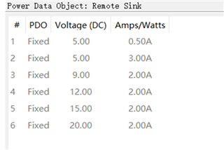

Hello Chris:
We have tested the BIN file, and use the PD tester read the information. It shows:
When read the old BIN file for TPS25750, it has 5V 0.5A.
I think the old BIN file use one of the PDO to cover the legacy USB ports. Could we do this for TPS25751?
Also for 5V 3A, the actually input current is 2.4A, is this normal? The old TPS25750 can have 2.8A.
Thank you!
Chen
  • Hi Chen,
    Per the PD spec, we cannot have multiple Sink PDOs with the same type and voltage. We can try it in the 751 project, but risk being non-compliant. The PDOs are specific to USB-C PD and are not used in legacy mode.
    When you are testing the actual input current, is the attached source capable of 2.4-A? Can you monitor the I2C between the TPS25751 and BQ device to see what current value is written during this time?
    Thanks and Regards,
    Chris
