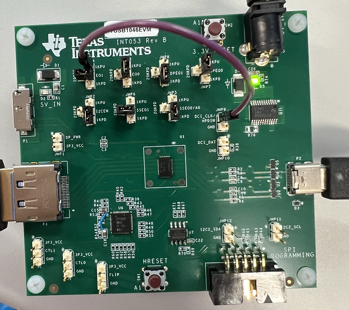

I cannot get USB data nor display port to work. I am attempting to use GPIO mode. I have a rev F TUSB1046EVM
I am using an external 5V supply at J5
JMP2 is installed horizontal to enable GPIO mode
I tried both installing a header on JMP1 and leaving it open.
I wired 3.3V directly to JMP9 to force HPD high
R37, R14, R12, R11, R10 and R8 are installed.
R69, R65, R63, R76, R36, R13, R9, R7, R53, R54, R52, R51 are not installed
I have tried the following settings using J1, J2 and J3:
  • Display Port 4 mode with no flip
  • Display Port 4 mode with Flip
  • One Port USB 3.1  no flip
  • One port USB 3.1 no flip
  • 1 port USB 3.1 + 2 lane DP no flip
  • 1 port USB 3.1 + 2 lane DP with flip
No matter what, I can't get any data nor display port to pass. I can only charge devices using the display port. Please advise if any of my configuration settings are wrong.
    Can you show an image of the board you're using? I've tested this board in the lab with the following JMP settings and it worked with no issues:

  • Hi Shane,
    I copied your settings and received the same results. I also read the other thread and made sure R36 was installed and jumped over the 3.3V.  I have tested with two different EVMS and neither passes Display Port Data or USB data.
    I'm not sure I understand how yours is working. Nothing is controlling the jumpers to set the mode at J1-J3 in the above photo?

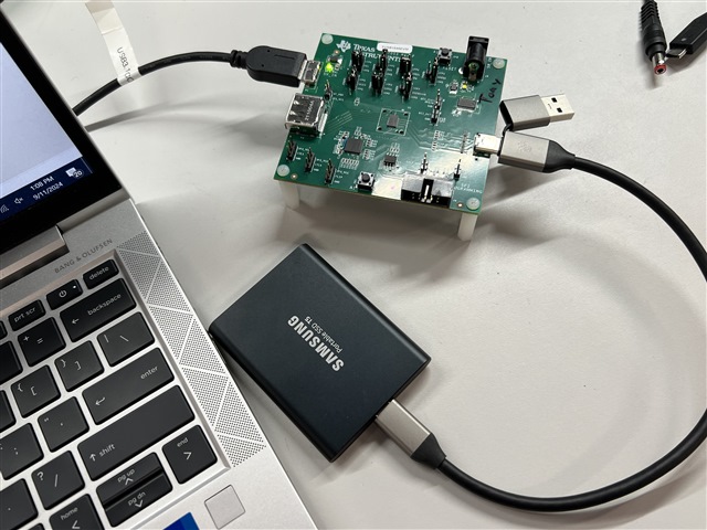

  • I have removed the jumpers and saw a message appear once that said the "Displayport device you connected may be limited" but won't recognize it or connect using the display settings.
    My setup for display port is HP laptop, HP USB Dock and Viewsonic USB display. I am able to drive the display through the following path: Laptop->USB C-->Dock->Display Port Out-> Viewsonic Display. The Display port cable is about 3 feet. I am trying to get my hands on a mini displayout to display cable so I can drive the monitor/EVM direct instead of through the hub.
    My setup for USB is HP laptop and USB A to C or USB C directly to the cell phone and am able to make a connection and move data. When I connect to the EVM I can charge the phone but receive no data. The USB cables I am using are about 1 foot.

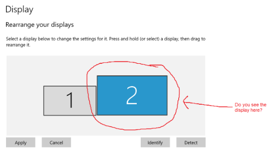

    As for DisplayPort, you should at least see the display show up on your host. Have you been able to try this without the dock in your signal path?
    The steps for debugging DisplayPort alt mode is to first check that HPD is high (3.3V) on the EVM when a device is plugged in, then check that your AUX common mode voltages are correct. You can probe the AUX lines with a multimeter or scope to see the common mode voltage. AUXp should be between 0 and 0.4V, while AUXn should be 2.7 to 3.6V when the DP sink is attached.
    Are you seeing HPD go high and the correct AUX Vcm?

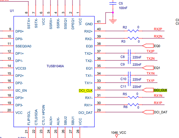

  • Some other items I found in my investigation. This dev kit has no pull ups on the schematic for AUX and the TUSB1046 datasheet  calls out a need for them:
    The datasheet also seems to imply that we could connect HPDIN to two different pins when I2C_EN=0 for GPIO mode :

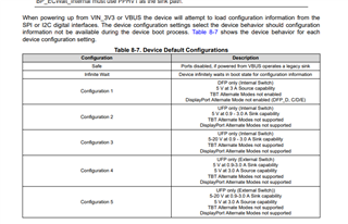

  • More information I read in the TPS65987 datasheet seems to imply I need to load a configuration to flash to allow alternate mode. Is this also required?
    This is ok because the TUSB1046 EVM sits between a DP source and sink. The pullups/downs are only necessary when the 1046 is used directly on the Source side (designed on the DP source board itself)
    In GPIO mode (I2C_EN = 0), the HPDIN pin is pin 32. In I2C mode, the HPDIN pin is CTL1/HPDIN (pin 23). Since you're configured for GPIO mode, the correct HPDIN pin should be pin 32.

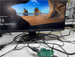

  • Hi Tony,
    I tested this board today and was able to pass video successfully. Here are the board settings I used:
    I had to drive HPD high using a jumper wire on JMP9. Please check that HPD is around 3.3V when plugging in your video sink.
    Here is the setup I made. Video passes from the PC, through the 1046 EVM, and to the monitor through the Type-C port.

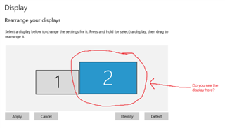

    Are you able to at least see the display show up on your DP source? Even if video does not pass through, you should still detect the presence of a display through the HPD signal.
    Shane
  • Not sure what's missing here. My PC doesn't recognize another display:

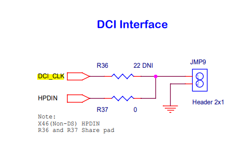

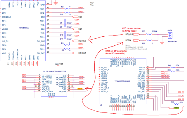

    I think the issue is that R36 is not installed on your board. R36 connects JMP9 to the HPDIN pin on our device in GPIO mode:
    Can you change the resistor installed on R37 to the R36 position? If I'm not mistaken, I believe these resistors share a PAD.
    If you cannot, do you have a way to drive 3.3V to the R36 pad opposite JMP9? This should at least let the source see your display.
    It seems the board you have may be configured for I2C mode by default. I suspect this is why R36 is not installed, as R37 would be the correct path for the I2C mode HPD signal

  • Hi Shane, I moved the resistor from R37 to R36 and that unfortunately did not do the trick
  • Hi Tony,
    Is the pad on R37 driving high (3.3V) when a display is plugged in? The PD controller should be driving this signal high when a monitor is plugged in to the type-C port. Perhaps something is preventing this.
    For context, the connection from R36 is the HPD signal for our device in GPIO mode. The connection from R37 is the HPD signal of the upstream DP connector. Due to the way this board was designed, these are two separate nets that both need to be driven high. One for our device, and one for the upstream connected DP source:
    If the PD controller isn't driving this signal, something may be affecting the CC ALT mode negotiation over the type-C port. Out of curiosity, is the connected display providing VBUS on the type-C cable in your setup, or is the VBUS only coming from our board? VBUS should be sourced from our board.

  • Hi Tony,
    After testing the board you sent, it appears the PD controller firmware is not configured correctly. The firmware you had on the PD controller was setting HPD correct, however it was not setting CTL1 high. Because CTL1 is our video-enable pin, this causes video to not pass through the board.
    In testing, I found that the board you sent can pass video once CTL1 is pulled high with a jumper:
    David and I are looking into why the default firmware you received does not drive CTL1 with the PD controller team. I'll keep you updated with the progress.
    Shane

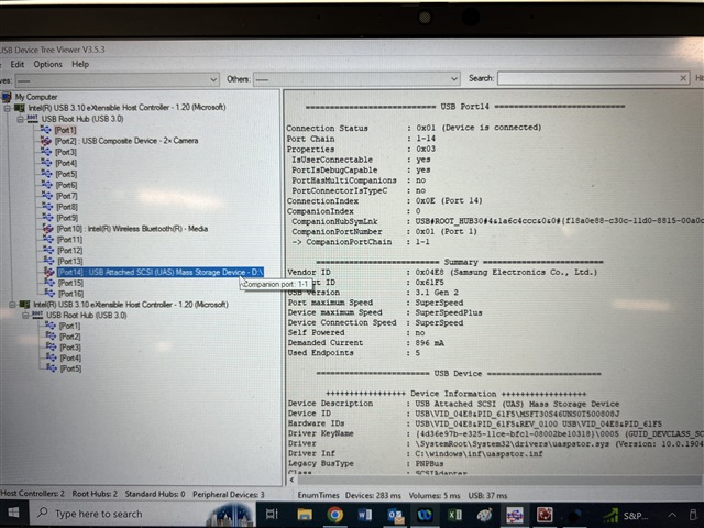

  • Hi Tony,
    I tested USB on this board with 6 different devices and they all worked except the one I used yesterday. I think the issue was with that specific SSD, not the board.
    Now that both USB and DisplayPort are working, I can ship this board back to you. What's a good address to return the board to? If you'd rather not disclose this on the public E2E forum, you can accept my friendship request and send me a private message.
    Shane
  • I setup the repaired unit this morning. I confirm that USB is working. However, Displayport is not. Is there some reason why this would be incompatible with this display?: ViewSonic VA2447-MHU, 24" 1080p MVA Monitor with HDMI and USB-C
  • It does think its driving at least CTL 1: 3.3, CTL0: 0, FLIP: 0 and then when flipping CTL 1: 3.3, CTL0: 0, FLIP: 3.3
  • What voltage do you see on HPD? (JMP9)
  • Its good that HPD and CTL1 are being set correctly. Do you see the display appear on your PC?
  • No, the PC does not recognize the display. I just get "We didn't find another display"
  • Hi Tony,
    I've just confirmed this board works to pass video with two different PCs and monitors:
    Dell U2719D monitor + Dell XPS 8700 PC
    Dell P2720DC monitor + HP Prodesk 600 G5 PC
    This may be an issue with your monitor, PC, or the DisplayPort/USB-C cables you're using. Are you able to try a different combination of PCs/monitors/cables?
