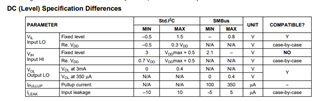

Does BQ40Z50-R1 support I2C operation?Why if not?
My design context is that a charger SC8886S with I2C interface  supported only is connected to EC and the battery protector chip is BQ40Z50-R1 with SMBUS support. The battery and charger are connected together using CLK and DATA commonly to the same port on EC which supports both SMBUS and I2C.
I have no intention to split battery and charger connection to single port on EC due to lack of SMBUS/I2C port on EC.
