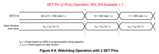

I am interested in using the TPS3436-Q1 supervisory function.
I am specifically looking for an option with a latching output which will trigger if the input remains in one state for too long (either high or low).  I need the output to stay off after the trigger event until it is either power cycled or manually reset.
I think the TPS3436-Q1 with the latching option enabled is a good fit, but I am not sure if the two currently orderable part numbers (TPS3436BFACADDFRQ1, TPS3436CCCBGDDFRQ1) will actually do what I want in this case.  If neither of these parts work, is there another part you would recommend?
I think I want to use the one with pinout "C", but from the orderable part number information it seems that TPS3436CCCBGDDFRQ1 is not actually latching since it doesn't use option "J" latched output.
