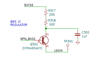

In the previous post,  it was believed that the power regulator failure was a one off event but it has since been discovered that this is a recurring issue. After replacing the board in the failed battery, the system worked properly for several days and then without any warning experienced the exact same failure as the previous board. More information was gathered with this occurrence and is outlined below. Any help in diagnosing why this is happening and what is causing it to happen is greatly appreciated.
Problem Behavior
Capacitor C302 and BJT Q301 front the power regulation circuit below become extremely hot and the BQ79616 becomes inoperable. This behavior persists until power is removed from the board/chip but does not appear to  return immediately upon reconnecting the board to the battery stack. When in the failed state, capacitor C302 measured  over 190F with an IR temp gun and Q301 measured over 130F. Heat could be felt rising from the board and it smelled of overheating electrical components. The output voltage of the BJT was 3.85V.
Ref Description MPN
C302 CAP, CERM, 1uF, 100V, +/- 10%, X7R, 1210 C1210X105K101T
Q301 TRANS NPN 150V 1A TO252 ZXTN4004KTC
R317 RES, 200 OHM, 1%, 2010, SMD RMCP2010FT200R
R318 RES, 100 OHM, 1%, 2010, SMD RMCP2010FT100R
Problem Scenario
The board in question was operating normally for some period of time (days/weeks). The chip was addressing properly and communicating without any apparent issues. Upon powering the host controller and attempting to address the stack chips, the chips failed to address and the first stack chip exhibited the overheating capacitor and BJT issues. The second stack chip did not present with these issues but of course was not addressed due to the failure of the chip before it. (This system does not implement the ring architecture) When the issue occurred, the chip should have been in a sleep state. Once the problem occurs, the problem persists and the chip becomes non-responsive and inoperable until physically disconnected from the battery stack.
This exact issue is confirmed to have occurred twice. Both times in the same battery module and both times it was the first stack board which failed. The issue is suspected to have occurred 3 additional times but in each of those 3 cases the boards were replaced before testing for overheated components and the issue did not re-occur.

Ideas and Theories
  1. The C302 capacitor is shorting to ground and sinking an excessive amount of current causing the BJT not to function properly and the BQ79616 to become unresponsive.
  2. Metallic mounting hardware leads to a scenario where the board is shorted and problem behaviors occur.
Useful / Relevant Information
  • System architecture is comprised of a single host board with a BQ79161 acting as a COMM transceiver connected to one or more stack boards via a twisted pair wire with cap only isolation.
  • BAT voltage to the stack chips is between 44V and 68V depending on battery state of charge.
    • Stack chips are fully populated with all 16 cell voltage connections and 8 GPIO connections to thermistors.
  • C302 is oversized based on the Ti reference schematic which suggests a 0.22uF capacitor.
  • C302 is a single capacitor and not two capacitors in series as is suggested in the Ti design reference.
Questions
  1. Would a short to GND of C302 cause the BJT to become non-functional?
  2. What scenarios other than a short to GND would cause the C302 and Q301 to overheat even in a sleep or shutdown state?
    1. Where would we look schematically to find a potential design issue?
  3. Could C302 being oversized (1uF) versus the 0.22uF in the design reference cause any issues?
  4. Is it an issue that C302 is just a single capacitor and not two capacitors in series, as suggested by the Ti design reference document, cause any issues?
  5. Can you think of a scenario where a High Voltage isolation issue somewhere else in the battery or vehicle would cause an issue?
  6. Why would this exhibit as an intermittent failure and be very difficult (so far impossible) to reproduce?
  7. Do you have any ideas on how we can intentionally replicate this issue in a testing environment?
  8. Is there any logical explanation as to why the problem seems to occur either on startup or shutdown?

  • Blakely,
    I can answer some of the questions immediately, the rest we will need time to look into:
    1) Yes. If C302 was replaced with a short circuit, the device would not work.
    4) While two capacitors would be better at heat dissipation, these parts should not get this hot.
    I have some follow up questions:
    1) Is this happening with multiple different battery packs, or just the one?
    2) When it failed the other times was it also the first stack device that failed?
    3) I am unclear with what you mean by:
    I am unfamiliar with the BQ79161, perhaps it was a typo and you meant to say 616. If that is the case, is this device not connected to any cells? Is this just the device that is connected via UART to the host? Is this the "first stack device" that was causing problems or is the next device in the chain the problematic one?
    Ben

    In our analysis of the issue we have also identified a couple of potential issues with the PCB design but are unsure if these could be contributing to this failure or what other issues, if any, they may cause. Despite these issues, we have had these boards functioning as intended for several years with this current PCB design.
    1)  Ti notes a new recommendation for a 470nF capacitor between CB16 and BAT in the design recommendations document. Our PCB design does not include this capacitor.
    2) Several issues were identified with the UART layout on both base and stack devices. It is unclear what if any role the level shifters play in this.
    1. Base device RX is pulled to VIO with a 10k resistor instead of CVDD with a 100k resistor as recommended in the documentation.
    2. Base device Tx is pulled to CVDD with a 10k resistor.
    3. Stack device RX and TX are both pulled high to CVDD instead of being left floating.
    4. NFAULT is pulled to CVDD with a 10k resistor instead of 100k on the base device.
    3) There are no parallel bypass capacitors along side the decoupling caps on the LDOs.

  • Blakely,
    Sorry for the delayed response.
    My colleagues and I have discussed this and the evidence here indicates that this is not an issue with the BQ79616 device.
    - This only occurs in a small percentage of your battery packs
    - The only pack that has had repeated incidents had issues with two different BQ79616 devices
    - The BQ79616 device in that pack shows no sign of damage and is fine when placed back in the pack.
    - This issue is not reported from other customers
    I would recommend investigating other potential causes.
