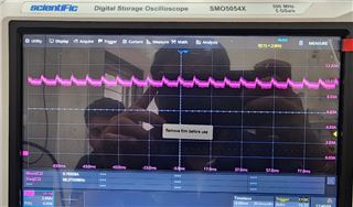

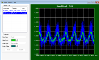

I ma reading the CC2 value in 10mA resolution. We have measured the value on CAN and Scope.
While the measured value on scope has 100Hz oscillation but the values reported by AFE are way too slow in reflecting the same. Below is the reference schematic diagram for SRN and SRP.
We are using only 1 shunt resistor 0.5 miliohms and CCGain = 0x41723055 and CC Capacity = 0x4a89c74d
In the above image Blue signal is Current reported by CC2 and Green is filtered current using LPF.
Above is the image of same current measured on the scope, the ripple that you see is 100Hz, but for some reason the same response on AFE reported CC2 values are are in seconds. I
I would like to have your expert advice on why this could be happening.

  • Hello Vikram,
    Are you measuring at the device pins? There are RC filters near the pins that could also alter your captured waveforms.
    FULLSCAN also takes ~189ms by default, therefore there is a high chance of aliasing occurring. You can turn on the ADC to be faster (~94ms), but it may be less accurate. The 0x3A CC2 Current() command will be useful instead if you choose to try that option. Section 4.3 Coulomb Counter and Digital Filters in the BQ76952 Technical Reference Manual may help with more information regarding it.
