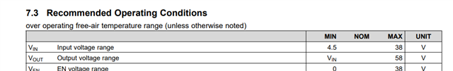

    2, Is it possible for TPS43060 to work in bypass mode? Vout=Vin? If so, is the duty cycle 100%?
    The TPS43060 does not support that mode where the high-side FET is on for 100% of the time.
    Please use the LM5122 or the LM5123 for that purpose.
    3, if TPS43060 output voltage is higher than input voltage, will it lead to some internal protection to prevent this case?
    The TPS43060 will just stop switching in this case.
    All load current will go across the body diode of the high-side FET.

    >> Do we have more detailed description about TPS43060 CBC current limit protection? Such as how it work and how many circle will it detect. I don't see too much description in this function
    In case of the TPS43060 there is no real (additional) protection mechanism.
    The controller is using a Peak Current Mode Control loop.
    It first turns on the low side FET. Dependent on the inductance, the current through inductor and low side FET will rise.
    How does the controller know when to turn off? It does NOT use the "nominal" duty cycle.
    It will turn off, when the voltage on the current sense resistor exceeds the threshold.
    Due to the slope compensation ramp it will actually be a bit lower.
    So, in the end it is the current sense resistor which defines the peak current through the inductor.
    >> Can we observe the CBC current limit through capture some pin waveform?
    You can use a current probe to measure the current through the inductor.
    This will show you at which current the low side FET will get turned off.
