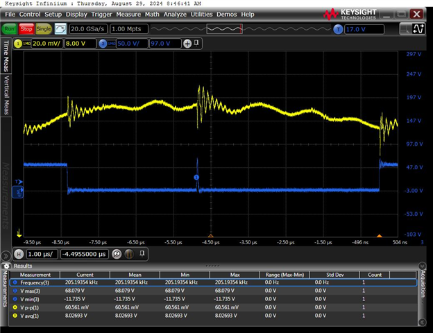

Observed one pulse in every two is missing and duty cycle is incorrect.
Can you help look into this issue?

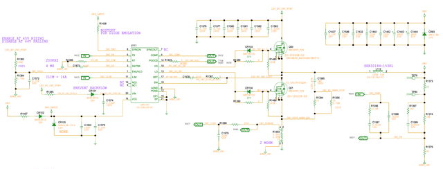

Schematic:
Yellow- Vout, Blue- Switching node
Yellow- Vout, Blue- Switching node, zoom in

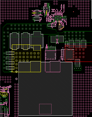

    Below the snap shot for layout. Do you need layout file for review?
    Red-Input, Yellow-Output, Green-GND.

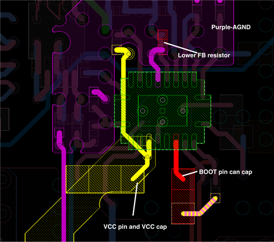

    4. CR102 needs to be a Schottky to have any chance of pulling VCC above its nominal 7.5V and thus derive bias power from Vout.
    5. Make sure the VCC and BOOT caps are close to their respective pins.

    5. Confirmed VCC and BOOT cap are very close to respective pin.
    6. Confirmed lower FB resistor is close to FB and AGND.

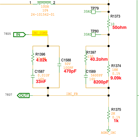

    I tried to tune loop parameters, when increase C1588 to 330pF, the switching node got changed to have two normal pulses plus one abnormal pulse. Previously with C1588=100pF, there was one normal pulse plus one abnormal pulse.
    Please provide your comments.
    C1588-=100pF
    C1588=330p

    Some of the above recommendations were general circuit improvements (not related to this issue). The VCC and BOOT caps look large here. You should use 0603 size for these and place them the same as what's shown on the EVM. Also check the RT resistor placement that it's close to the RT pin.
    Here is a file that checks the effective Cout and ESR with two cap chemistries...it's important to get the effective Cout and ESR to model the compensation in the quickstart. Increasing the cap you mentioned from 100pF to 330pF reduces the pole frequency.

    As for bode plot, looks like LM5146 is very sensitive to AC injection amplitude when measuring the bode plot. I changed ripple injection resistor from 10ohm to 50ohm and use adjustable AC amplitude, i can see a much clear bode plot from 100Hz to 100kHz. After 100Khz, even the amplitude is minimized to 1.25mV (FRA is AP300), i can still see rinings on bode plot, and the output ripple became unstable as shown below. Please advise for next step.

    Can you use the latest version of the quickstart file online and place the high-frequency pole at Fsw/2 (using the cap from COMP to FB). This attenuates any high-frequency noise. Also, make sure the SS cap and RT resistor are close to their respective pins with short GND return.

    For light load the output ripple and bode plot looks ok, but with >9A loading, the bode plot looks uncontrollable and high oscillation can be observed on output ripple at steady state. For all conditions, the pulse is incorrect with one pulse missing in every 2 or 3 cycles.
    Please advise next step.
    Here is the waveforms.
    Bode at 7A loading.
    Bode at 9A loading.

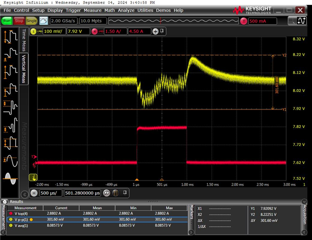

    0-3A load step:
    8-11A load step:
    SW at 7A loading:

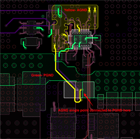

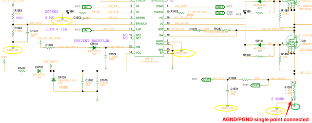

    For AGND connection, in my design AGND is single point shorted to PGND at the RLIM pin.
    Here below is the schematic and layout. Do you see any concern?

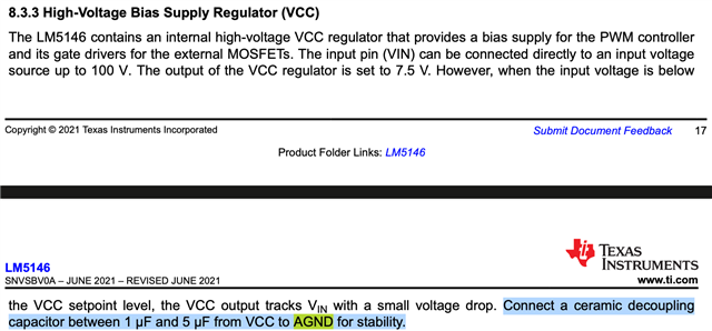

    And also, datasheet requires VCC cap to be connected to AGND, as VCC drives MOSFET which is noisy, shall the VCC cap be connected to AGND?
