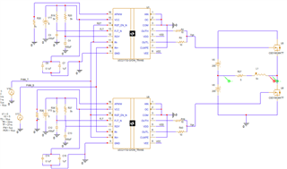

I am trying to simulate a half-bridge invertor in UCC21732 as follows (image attached). So, my questions are
  1. How is the connection of Rest Pin when we use two gate drivers ?

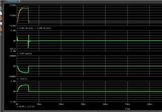

  2. Could you please correct me for circuit building of the invertor while we use UCC21732, because I did not get the proper result? and I'm just getting unrealistic results.
  • Hi Biruk,
    I'd recommend tying nRST/EN pin to VCC for now.
    What's the purpose of R27/L1?
    Also, my experience with PSpice is that half-bridge is difficult for PSpice - runs into convergence issue, etc. So I would recommend starting the circuit simple: driving capacitors with gate driver output, or only driving one power switch with one gate driver. Once it starts producing correct result gradually add onto that simple circuit.
    Vivian
