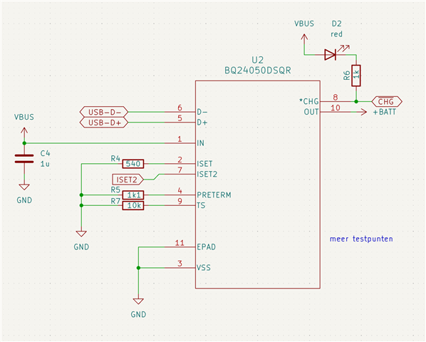

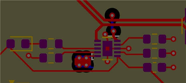

For some reason, I cannot get BQ24050 to charge.
See schematic below
VBUS and VBATT have more capacitors connected off-screen. No current is flowing at all. Battery is at 3.85 V. TS is at 500 mV. ISET is a 0 V.
I have connected various chargers, as well as a computer with D+ and D- connected.
I have forgotten to connect ISET2, however I think it should charge at 100 mA anyway, is this not correct?
Thank you in advance.
