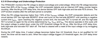

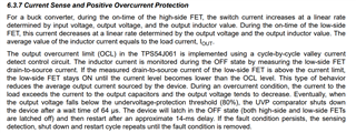

Hi team,
May I know the fault response for all faults? Could you please confirm?
(1) OCL: I think it is auto retry
(2) UVP: I think it is auto retry
(3) Negative OCL: I think it is auto retry
(4) OVP: I think it is Latch
(5) OOB: I think it is auto retry
(6) UVLO: I think it is auto retry
(7) TSD: I think it is auto retry
  • Hi Naizeng,
    The responses are stated in the datasheet.

  • Hi Nison,
    (1) OCL: LS FET is on until current is less than OCL
    (2) UVP: After FB is lower than 80%, there is a delay and then device latches off. The device will try to start up again after the soft start.
    (3) Negative OCL: When negative OC is greater than -3.5 A, device turns off LS FET and turns on HS FET. After HS FET on time, LS FET turns on again.
    (4) OVP: After FB is greater than 116% than Vinref, ovp latches off HS FET driver turns on LS FET until it reaches negative OC. Then LS turns off and HS turns on again
    (5) OOB: LS FET turns on to discharge, then gets output voltage to setpoint.
    (6) UVLO: Non latch, shuts off device when VCC voltage is less than uvlo threshold, once it is higher device turns back on and soft starts
    (7) TSD: Non latch Stops switching and discharges ss. After temp drops 38 C below threshold, device turns back on with soft start.
    Ryan
  • Hi Ryan,
    Thanks! It seems that only OVP will latch the device.
