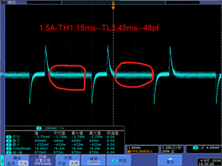

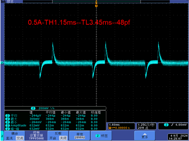

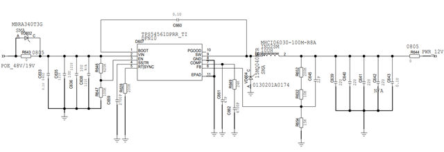

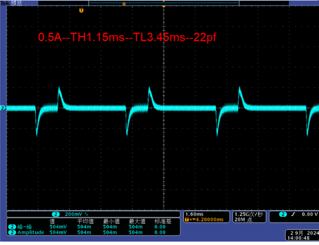

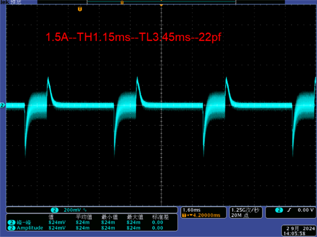

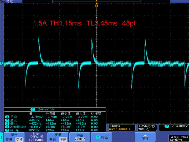

This is FAE Jayden, ZTE is using TPS54561in their new CPE project. And they find the voltage ripple is large during the transient test. Could you help check the schematic and give some advice on their design?
Test report and waveforms:
Iout= 0A to 0.5A to 0A, cff=22pF
Iout= 0A to 0.5A to 0A, cff=48pF
Iout= 0A to 1.5A to 0A, cff=22pF
Iout= 0A to 1.5A to 0A, cff=48pF
