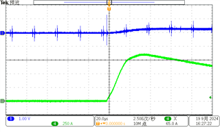

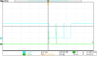

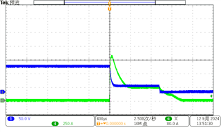

Recently, we were debugging the SCD functionality of BQ76952 and encountered some issues. We used a large instantaneous current (250A  within 400us) to trigger the SCD, but we found that the instantaneous current did not trigger the SCD normally.And then when we used a slower rising current(250A  within 0.5ms), it did. As shown in the following picture:
instantaneous current:
 slower rising current:

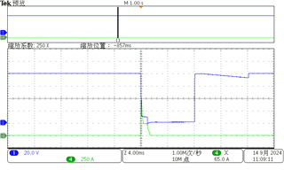

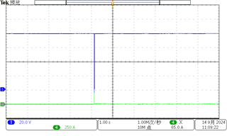

    I changed the resistance value of the galvanic resistor, now it is 0.167mR(3*0.5), and the short-circuit current is 815A as shown in the attached figure. In addition, the output voltage is also measured synchronically. The interval from output closing to re-opening is 8.1ms, and the short-circuit protection action takes about 1ms. why?
    Time reference 1s
    blue is output voltage
    green is current
    Best Wish

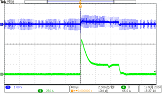

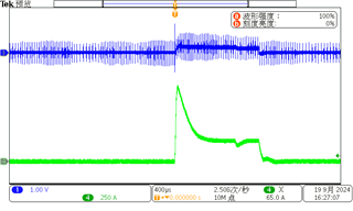

  • Hello Max Verboncoeur,
    Thanks for reply,here is the image:
    CH1 blue :the voltage between the SRP and SRN pins
    CH4 green:short-circuit current
    Looking forward to your prompt reply.
    Best Wish

  • Hi Zhang,
    The new waveforms are a little difficult to read since the vertical scale on the SRP-SRN voltage is so large. 1V/div makes it difficult to see what the voltage level is on the signal.

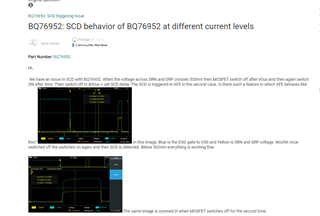

    Looking back at your earlier waveforms, this looks like the device reset caused by an SCD transient that you found another E2E explaining. Since you mentioned that a slower ramping current does not experience this, I want to focus on that possible root cause.
    Did you populate C54 and C55 on your schematic? Have you captured a waveform of SRP-VSS and SRN-VSS to see if the transient is there and if adding the capacitors suppressed it?
    Max Verboncoeur
