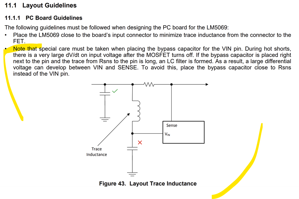

LM5069: Add resistor in VIN path
Part Number: LM5069
Hello.
We want to add a 1 ohm resistor to the VIN path. Is there any problem when adding this 1 ohm?
The reason for adding the resistor is to prevent short testing between the VIN and GND of the IC.
It can prevent the printed pattern from burning lost.
We would like to know the reason why you answered "Please remove the resistance from the VIN path." in the following query.
Best regards.
