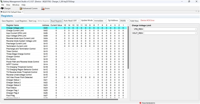

    Can you provide an image of BQstudio when the device is not communicating?
    I also recommend using just the adapter when trying to communicate to the device for the first time.
    Christian.
  • Hi Christian,
    Thank you. My apologies, I did try the USB2ANY with the TI Charger GUI. It was not detected on either computer after trying both the chrome extension and offline bridge packs.
    This issue did happen when hot plugging the battery. We have not tried it without. We need to build a new board because it burned up the pads and traces on the IC. I was applying 48-50V with DC power supply to VIN on our custom board which is very closely related to the EVM (basically removed the DNP pads and modified the resistor dividers per the datasheet).
    Do you have an expected ETA for a fix? Or recommendations for trying? Is this guaranteed to only be an issue when hot plugging? We have seen pretty big sparks on connecting the battery without first using a DC supply to charge up the caps.
    I will reply with the image from BQStudio from the other PC.
  • Please note Device ACK error

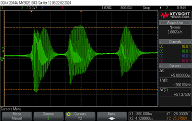

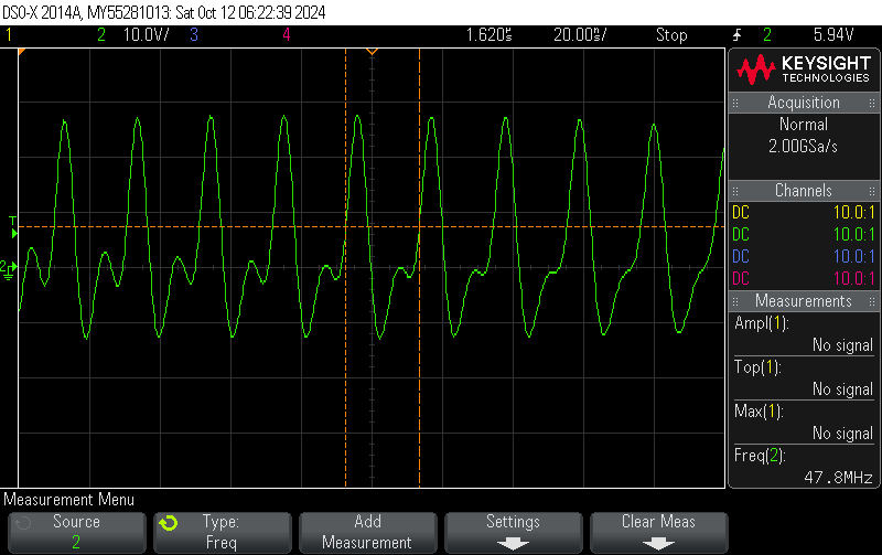

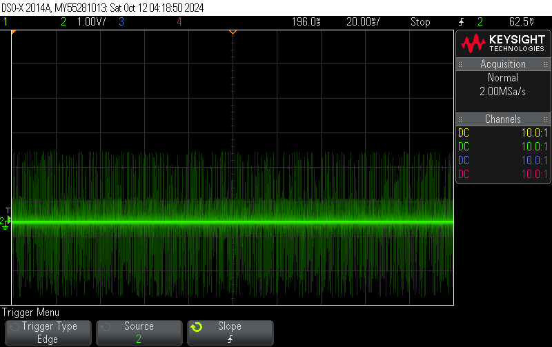

    At 49V, the gate voltage is exactly 10V as described in the ACDRV section of the datasheet. However, if we change to 48V it drops to approximately 2.5V which greatly increases the RDS of the MOSFET and it overheats. At 50V we see approximately 9V. At 49V we see approximately 8V. Why is this voltage not stable?
    The scope image below shows the ACDRV gate voltage at 49V input and then transitioning to 48V input.
    Second update: This seems to have some relation to the battery voltage. As I let the battery charge, 49V stopped driving 10V on the gate, and I had to increase it to 50V on the input to get the 10V on the gate. The battery voltage at that time was 46.8V.
  • Both of these waveforms are using the common source of the ACFETs as a reference. Blue is VIN and Green is the gate voltage. This is just manually turning the supply on for just a moment at 48V (so I don't overheat the MOSFET). There is quite obviously an issue here, but I'm not certain where to go from here. It looks like we could use a capacitor in to absorb the oscillating spikes after turning off, but that won't help the < 10V on the gate issue.
    Can you give more information on how ACDRV works? For what it is worth, without any diode on there we do not see any voltage change on the gate when VIN is applied. I have also replaced the zener with three brand new diodes of different manufacturers and all behaved the same way. So it seems this is likely related the ACDRV signal.
    Why does the EVM have a zener on the ACFET gate but not the BATFET?

  • Hi Christian,
    This is on our custom board. The EVM has a short to GND on ACUV that keeps reappearing so it is unusable.
    We replaced the IC as well and still have the issue. The gate voltage changes with every volt change. Interestingly, the gate works well enough (5V) from 25-40V and 50V. I also noted that it moved up a volt as we charged the battery a little bit. So for some reason, it seems to be following the battery voltage which is at roughly 46V.

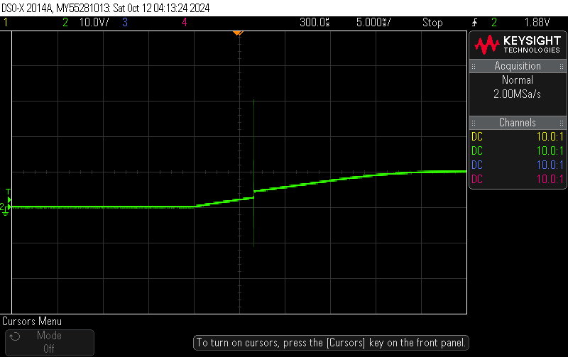

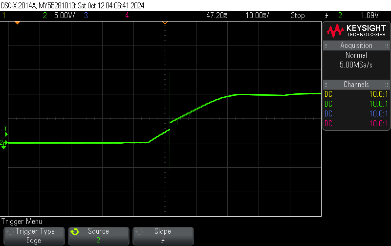

  • Thanks Ethan. Confirming I am using the BATFETs from the EVM which are over 2V Vgs(th).
    I added the 10nF cap as a starting point and scoped out the BATDRV with one battery. This is with the probe referenced to the common source of the BATFETs.
    There are some pretty nasty spikes in here which is likely where the damage is happening (curious how big this spike was BEFORE the cap). Is there any reason that we wouldn't want to put a 15V zener across this similar to the ACFETs to protect from the initial voltage spikes?

    BATDRV is referenced to BATSRC inside the IC so that pin doesn't need a zener diode. Because ACDRV doesn't have a pin similar to BATSRC, ACDRV needs the zener diode to prevent the gate from rising 20V above the drain.
    For your bottom image, are you measuring BATDRV with a diff probe? The IC limits the inrush current to 8A. The spikes are the IC turning on the BATFETs and turning the BATFETs off when the current gets too high. This mode is active only when the power path is switching over.

  • Hi Ethan,
    My apologies, I should have described the captures better. They are both the same capture which is a system with no power and the battery connection triggers the scope. The first image is zoomed in on the initial spike from when the battery was connected. The second capture is just zoomed out to see the gate stabilize.
    There is no power applied to VAC so there should not be a power switchover. Any thoughts on where to start there? I'll add a probe to VAC just to make sure it's not making it through the ACFET somehow. I do have the ACUVACOV set to GND/VAC. Could this be startup noise making it onto the resistor divider?
    The only load on the system in the capture is a few DC/DC modules which do not have a load applied to them

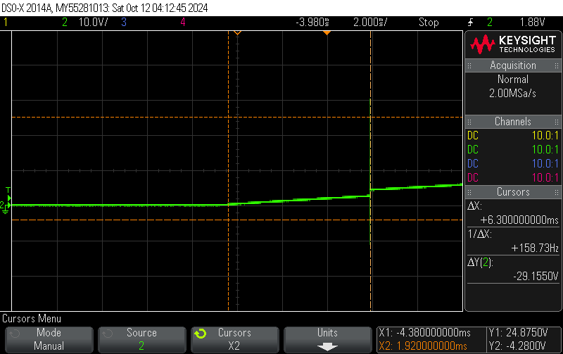

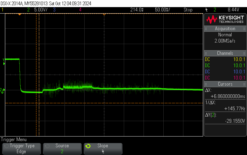

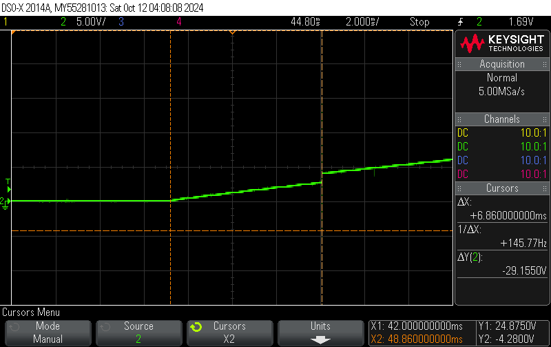

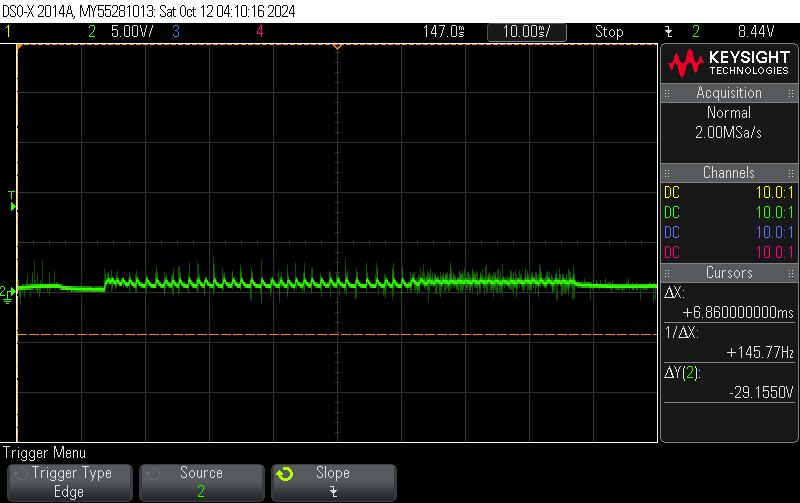

  • We are seeing a 30V spike on BATDRV referenced to BATSRC when the charger turns off which exceeds the Vgs max rating of the MOSFETs. This spike is also there when the battery is first connected to a dead system, but it is not as significant. There are a few scope captures which are all interesting in their own way.
    This capture is BATDRV referenced to BATSRC when the battery is first connected to an unpowered system.
    This is a zoomed in image of the same capture to show the spike timing of roughly 6.8 ms. Something clearly kicks into overdrive in the chip at this time as the slope of the gate rise dramatically changes for a moment.
    This is a capture of the of BATDRV referenced to BATSRC when VAC is first powered. I'm not thrilled about what is happening here either, but I don't think this is necessarily what is causing the failure, although it certainly is not doing anything good.
    Here is a zoom in on the gate oscillations from the previous capture from VAC power-up
    This is a capture from the charger turns off, and where I believe that the failure is happening. Note the vertical scale has changed to 10V per division. We are seeing an over 30V positive spike at the same 6 ms timeframe from when BATDRV starts to a large voltage spike on the gate.
    Zoomed in measurement from previous capture
    This is what is on the gate after damage when the charger turns back on:
    What is happening in BATDRV 6-7 ms after switching on that is causing this huge voltage spike? This looks like a silicon issue.
    I am attempting to add a zener from BATSRC to BATDRV to limit the spike and go from there.
  • This is not a 6-7ms issue. It appears to be a 2.5V threshold issue when the spike happens. We removed the 100n capacitor from gate to source and replaced it with a zener diode, the same as used on the ACFET. The battery FETs have survived all of the cycling so far. We will remove the inrush current limiter and confirm that the issue does not reappear.
    I took some higher resolution captures of the BATFET gate when the spike happens. This capture is showing a 47.8 MHz oscillation on the gate:
    Here is a capture zoomed out a little further to see how significant this oscillation is- even with the 15V zener we are getting spikes that are +/- 25V and would clearly damage the FETs with a +/- 20V absolute max Vgs.
