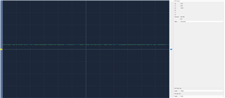

  • Hi Juan,
    thank you for your reply. Do you need the waveforms during specific events or just during normal charging, when the error occurs?
    So like this, for INT ar 150mA setting, for example:
    If yes, i will provide the rest of the waveforms. If you need it different, let me know :-)
    Best regards
    Lucas Heitele
  • Hi Lucas,
    If you can capture the behavior as charging is enabled so we can see the rail behaviors before charging, across the transition, and during charging then we might be able to get a better idea of what's going on.
    One thing I did notice is that the VINDPM flag seems to be active, this typically indicates that the input source is being overloaded and current limited as a result. Do you know how large your SYS, PMID and LDO loads are during this period? It looks like the input source is not able to provide sufficient current for both the system load and the battery charging. What is the expected VIN voltage and VIN current capability?
    Juan Ospina
