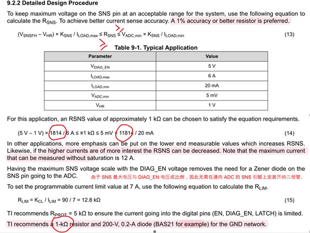

TPS1HC30-Q1: Questions for datasheet - detailed design procedure and KCL
Part Number: TPS1HC30-Q1
Hi Team,
Here are four questions need your support. Thank you!
1. When calculating WCA today, is there a problem with the resistance range below? The resistance on the left is larger, and the resistance on the right is smaller.
2. In the example in the figure below, the Ksns values ​​at 6A and 20mA are 1814 and 11814 respectively, which should be a problem;
3. For the GND network, when connected to a capacitive load, can the 1kΩ resistor be replaced with a 0Ω resistor?

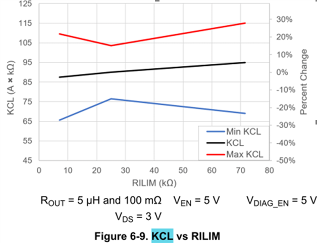

4. Are the maximum and minimum values ​​of KCL in the figure below also 6sigma distribution?
