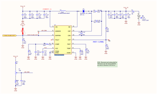

Hi team,
We are using part number of TPS923652DMTR for the buck operation. attached circuit is below, Kindly verify.
The input we are giving 5V and need to generate 3.15V voltage to drive a single led of forward voltage 3.15V.
Boost operations happening correctly with 5V input we are getting 21.36V.
