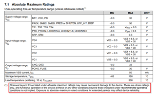

    The first table under section 7.1 lists the max voltage rating for VC1 as "VSS + 8.5, or VSS + 30" so we are wondering what is the "or" based on.
    Two more questions, sorry,
    Where can I find the stable version of BQStudio? It seems only Beta is available for download.
    We have an interest in using this chip to drive a single tri-color LED, as opposed to 3 or more LEDs, can this chip support a common anode or common cathode configuration to enable us to do this?
    Thank you for all your help so far.
    This information is in reference to the Absolute Maximum Ratings of the device. We would recommend following the Recommended Maximum Ratings specified in Section 7.3 to ensure the functionality of the device. Please see the warning below:

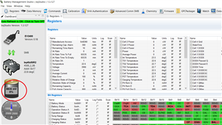

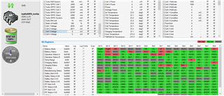

  • Hi Anthony,
    Here is the register front page.
    Thank you for pointing us toward the DA Configuration register. Now, we are seeing a charge level of 100% even though this is not accurate.
    What we have done is use our battery as a power supply and the VC pins as a voltage divider with 100kohm to simulate a 3 cell battery as described in the user guide. Is there somewhere where we are supposed to set a value for max/nominal voltage of the battery? (in the screenshot above it is displaying only two cells because I had gotten my red and green switched when setting the DA configuration, after updating it with a value of 3 cells it was able to read the full voltage accurately approx. 8V, our battery has a max of 12 and nominal 10 approx)
    Can you please elaborate more on the FET_EN command? Should that be sent automatically or manually?
    With gratitude,
    Layanne
  • Hi Layanne,
    Understood, thank you for clarifying.
    For the charge level to become accurate, a learning cycle will need to be completed to the device. The document below contains the instructions on how to accomplish this and the parameters that need to be set:
    https://www.ti.com/lit/pdf/slua903
    There are overvoltage protections and parameters within the gauge that can be set to reflect the maximum voltage of the cell. From a charging perspective, the main ones are the Valid Charge Termination and Full Charge parameters, which can be found in section 4.6 and 4.7 of the TRM below:
    https://www.ti.com/lit/pdf/sluua43
    The FET_EN command gives control of the charge and discharge FETs to the gauge based on what is being seen from the sense resistor. If the current observed is greater than the Chg Current Threshold, the CHG FET will become active, and vise versa with the Dsg Current Threshold and the DSG FET. This can be sent from the commands side of bqStudio:
    Anthony

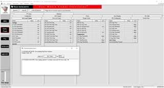

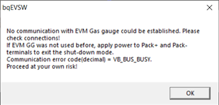

  • Hello Anthony,
    I found the BQEVSW related to the BQ20z65 (apologies, there is a typo in my previous reply, the chip in the battery pack is the bq20z655) from the advanced BQMTESTER page and updated to use the alternative for the EV2300. However, I am still getting errors when I try to use this software. Here are some screenshots of the errors.
    At launch:
    attempting to read data flash after launch:
    The team is currently out of office today. We will get back to you next week.
    BMS Apps Team
  • Hi Sardonic,
    . I am trying the bq40z60 for now, however what I see is that bqstudio is not detecting that I am connected to the HDQ port on the EV2400, it attempts to read from the chip using SMB protocol and then reports a failure.
    I believe that this might be due to the bq40z60 and bq20z655 not having HDQ functionality. Is there any issues with the bqStudio communication if these are connected to the EV2400 SMB port for communication?
    I have also identified that our battery has a bq40z655 gauge, however I don't see this gauge on the list of selectable parts.
    This might be due to a missing bqz file. Are there any other computers that are able to detect the bq20z655 around you?
    Anthony

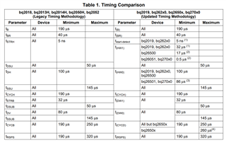

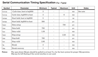

    That EVM was dead, we acquired a new one and it worked great out of the box. Right now though, we are considering adding a microcontroller to our design to read status directly from the battery pack. I have some questions about some of the timing discrepancies across datasheets.
    In the HDQ Basics application note "slua408a.pdf" the legacy timing requirements for a chip such as the 40z50 are described as follows
    whereas in the datasheet for the 40z50 the timing requirements are below
    There are some pretty big differences so I was hoping to clarify what this discrepancy means. So far, using the timing requirements as described in the HDQ Communication Basics document has not allowed me to communicate with the battery pack.
  • Hi Sardonic,
    I do not believe that the bq40z50 supports HDQ communication. Are there any current issues while communicating with SMBus?
