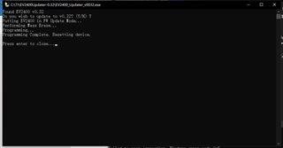

We use the BQ40Z50 for the fuel gauge solution, now, we can use the "bqStudio" to connect to BQ40Z50, and we conisider to use the "EV2300/ EV2400 and BQ-BATTERY-PROGRAMMER-SW",
but the EV2300 can't be connectted by the CMD, please refer to belwe picture and advise how to solve this issue, thanks.

  • Hi Anthony,
    We use the WIN10 system, and we use the EV2400 also can't connectted to BQ40Z50,
    Please refer to the below picture:
    And the below is the GUI from TI website, and please advise if this EV2400 is support the BQ40Z50 or not?

  • Hi Zhang,
    From that image I believe the computer is able to connect to the EV2400. When you are connecting it to the bq40z50, is ample power being applied to it correctly and is the wake button being held when trying to connect to bqStudio? The EV2400 does support the bq40z50.

  • Hi Zhang,
    The wake button temporarily connects the BAT and PACK lines to allow the device to be woken up if the DA Configuration does not reflect the correct amount of cells in use. If the bq40z50EVM is in use, this button can be found labelled as WAKE and should be held when bqStudio is opening.
