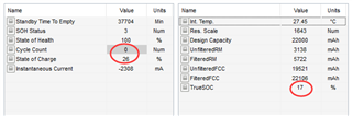

We used two matching chemical ID ,both of which are battery jumps.
Could you please help me see where the problem is set.

When did this issue start occurring? Has this always been happening after completing the learning cycle?
It looks the TrueSOC register is being reported correctly. I would recommend changing the bit OpConfigD [SMTHEN] to 0. This will allow TrueSOC value to be reported to the State of Charge register.

Are you able to get a log file showing this behavior?
