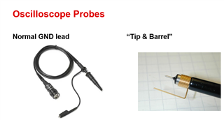

    2. Try measuring the voltage at U1-3 to see what is happening at the I_SEN pin during startup. Use single event trigger at startup. Measure the voltage at the pin using tip and barrel scope probe technique as shown below:
