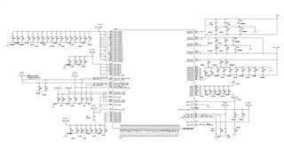

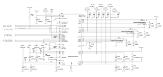

  • I've attached the schematic for the first question.
    The scope capture is too infrequent to capture.(about once in 1000).
    Also, it's not clear which signal is affecting it.
    *The circuit diagram "VFB3" has been made public, but I don't think it has any effect.
    This problem has been going on for a while and I have no idea what the cause is.
    This is why I am asking an additional question now.(PWRHOLD signal of "TPS65910")
