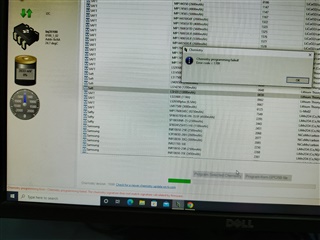

BQ35100: Chemistry programming failed. Error code: 1709
Part Number: BQ35100
Other Parts Discussed in Thread: EV2400, BQSTUDIO
I am trying to program a chemistry profile to BQ35100 for Battery (Make: Saft, P/N: LSH20, Capacity: 13000mAh). I am using the BQ studio latest version 1.3.127 and Chemistry version: 1099. But after selecting my Battery's profile (Battery profile ID: 0659) and clicking "Program Selected Chemistry", I receive an error with code: 1709 (Chemistry programming failed. The chemistry signature doesn't match signature calculated by firmware).
I have also updated the Chemistry version to latest one i.e. 1121 but still same error persists.  EV2400 Interface adapter is being used for I2C communication between BQ Studio and BQ35100.
While tried to load another Battery's chemical ID (profile ID: 0648), it got programmed successfully.
Please suggest on how to proceed with programming my required Chemical ID: 0659.
