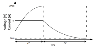

    So I see a few issues currently. First, some setting issues in data memory. Term Voltage should be set to 11V since the cutoff voltage of 1 battery is 2.75, 2.75 x 4 = 11V. In the log file, I see that in the initial discharge, the cell voltage goes down to only 12.7V. We want to discharge all the way down to 11V for the first discharge. Lastly, when charging the battery we want to achieve Valid Charge Termination.
    I see there is a constant current charge, but you did not implement a constant voltage charge. You need to do a constant current charge until the voltage reaches charging voltage. Then you will need to do a constant voltage charge until the current is less than the defined taper current.
    Should look something like this:

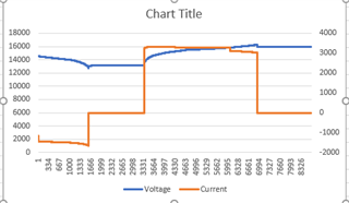

  • Hi Adrian,
    thanks for the feedback. Term Voltage and fully charged PACK voltage levels: i see your point! My problem is, that the cells (even if they are from the same batch) are not in balance durring the charge or dischcharge phase. According to the tech sheet of the gauge cell balancing just works after a 0E in the update status register, so its a kind of a chicken egg problem.
    I set those values to don't reach with a single cell the COV or CUV threshold. Is there any technique, how to get rid of the inbalanced cell problem during learning cycle?
    Charging: the cahger is charging now with 16,8V wich is actually the max cell charging voltage x4. Thats the reason it behaves like a constant current charger. I can set this value lower so the characteristic will match the graph you posted. But till the balance isn't working, my actual capancity in [Wh] will be way less as the theoreticle capacity 16,8mAh*16,8V=282,24Wh.
    How can i solve this issue?
    Thank you!
    BR,
    Maritn

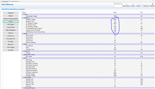

  • Hi Adrina,
    I did another cycle with adjusted data memory settings.
    I've set the Term Voltage to 11000mV as you recommended.
    I've adjusted the charging voltage, so the cell with the highest voltage was still bellow the COV threshold, while the FC flag was set and a charge termination allso occured.
    I've also attached he log files from the discharge and the charge. Unfortunatly my PC went down, therfore the charging logs are splitted in to two.
     I've played with the charger settings near to the end of the charging cycle to find the correct voltage value, where the COV hershold is not reached, but the FC is set and the term current is also reached.
    I'm still don't get a 05 Status but i assume it's because of my try and error?
    Is the discharge phase already okay, or do i still have to adjust something there?

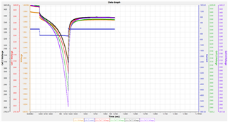

  • Hi Adrien,
    just a quick update: since the cells are not balanced, the cell 2 reached the Shut Down voltage in the discharge pase:
    So the ballancing is still an issue... any idea how to solve this?
    Should i set the FD and related settings higher?

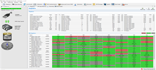

  • Meanwhile i continued trying to get the learning done. What i faced:
    Even if the XDSG is set, the Gauge reports a 3mA DSG...
    Is this a HW issue or Calibration? How can i get rid of this? The REST flag isn't set...
    Thanks!

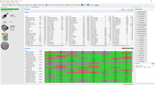

  • Hello Adrian,
    The problem was, that the CAL_EN flag was 1 as visible on the previous screeshot. I had to manually set it to 0 with the CAL_TOGGLE command.
    The learning was successful! No the Update Status is 0E!
    In the next step i've disconnected the battery pack and manually discharged one of the cell to check out the cell ballancing feature. After this i've restored everything.
    That brings me to my next problem: the cell balancing is enabled, and in the operation status B high register CB turned to 1, but i don't see any effect on the cell itselfe. i did another charge-discharge cycle to see if something happens, but the voltage difference remains the same.
    I've attached the data memory content and the log. ImbalanceTest2.log4718.Data Memory.gg.csv
    Can you help me with this?
