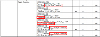

    I believe so. It's not super obvious from the datasheet and I had to look through it to find a hint, but in the EC table it is mentioned that tantalum capacitors were used for characterization.
