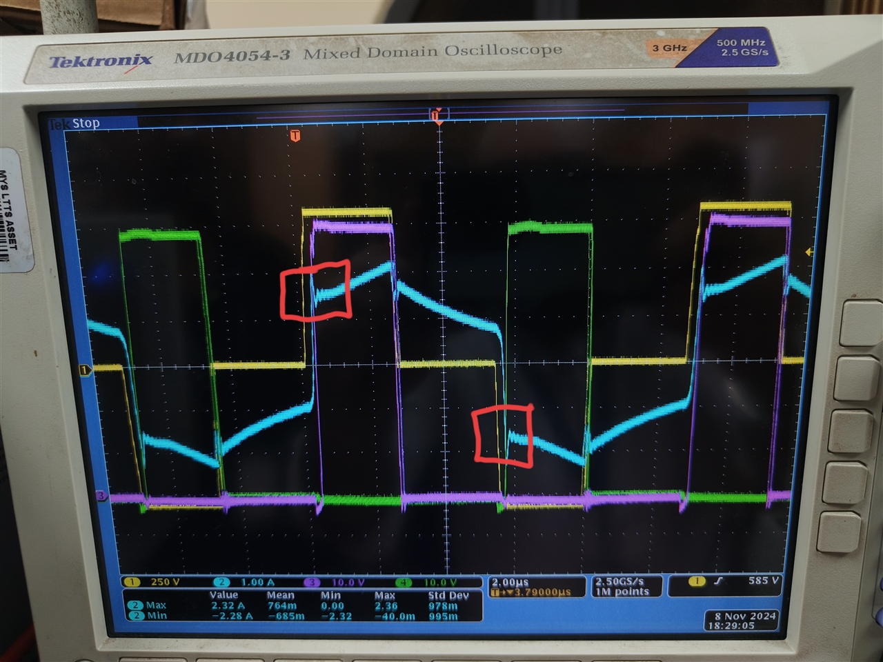

Test conditions : 812VDC,  full load is 43A @Vout 23.5V
Below are images at different loads and different delays. I'm testing with different delays and different shim values.
Yellow: transformer primary voltage
Blue : transformer primary current
Purple, green: synchronous FETs drain source
1. VIN : 812 VDC, DELAB : 8.2K , DELCD: 8.2K , DELEF : 8.2K
LOAD : 25.8A, Llkg + shim : 22.6uH + 20uH
2. VIN : 812 VDC, DELAB : 8.2K , DELCD: 8.2K , DELEF : 8.2K
LOAD : 25.8A, Llkg + shim : 22.6uH + 30uH
3. VIN : 812 VDC, DELAB : 8.2K , DELCD: 8.2K , DELEF : 8.2K
LOAD : 33A, Llkg + shim : 22.6uH + 30uH
I want to understand the flat region in current and why the dip in that region by increasing current . What is happening and what more can be done to make the design better. ?

    Increasing the size of your shim inductor seems to be creating the flat spot according to your waveforms.  It appears that the extra energy stored in the shim inductor is creating a current to counter act the reflected output current in the transformer and the transformer magnetizing inductance.
    I am wondering if your shim inductor to magnetizing inductance to too small.  The shim inductor is only needed to add extra energy to achieve ZVS.
    I wonder if you make the shim inductor less than 1/10 the magnetizing current if the issue goes away.

    I think your shim inductor current and transformer current are different when the design comes out of freewheeling.  The larger the shim inductor the more energy that is stored in the shim inductor during freewheeling. You can verify this by studying the current through the shim inductor and the transformer.
    When you come out of freewheeling the transformer's primary current and shim inductor current need to change direction.  In your design the shim inductor seems to be preventing the current from rising generating a flat spot in your current waveform.

    In regards to your original question of a flat spot/down slope in your primary transformer current.  I think your shim inductor current and transformer current are different when the design comes out of freewheeling.  The larger the shim inductor the more energy that is stored in the shim inductor during freewheeling. You can verify this by studying the current through the shim inductor and the transformer.
    When you come out of freewheeling the transformer's primary current and shim inductor current need to change direction.  In your design the shim inductor seems to be preventing the current from rising generating a flat spot or down slope in your current waveform.  This is dependent on the size of Ls that you used in your design.
    The transformer primary current (di) has to be related to voltage across the inductances in your design; as your, transformer turns ratio.
    di = V*dt/L
    Np/Ns = Vp/Vs = Ip/Is
    I did look through my previous designs for phase shifted full bridge converters and do see a leading edge spike coming out of freewheeling and it is not that aggressive, or flat, but it is there.
    When I look at your waveforms the first waveform looks similar to mine with a leading edge spike and not a flat spot.
    Then you increase the shim inductor and get this primary current transformer below changes shape.  I have not seen waveforms like this before, but I believe your shim inductor may be larger than most designs I have done or reviewed.
    I think this behavior is based on the design having to reverse the current direction in the shim inductor of your design.
    When you come out of freewheeling the shim inductor current will be as follows. Please note this current will be in the opposite direction and will be fighting the the reflected output current.
    - ILs_free_wheeling = Iout - Change_ILout/2
    I believe that your flat spot/current down slope in the primary current is due to over coming the negative current in your shim inductor after changing polarities.
    To reduce this down slope and/or flat spot would require reducing the shim inductor (Ls) in your design.  You actually have proved that already by experiments that you have taken.
