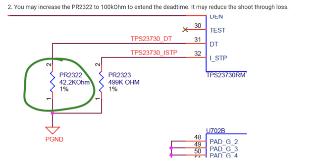

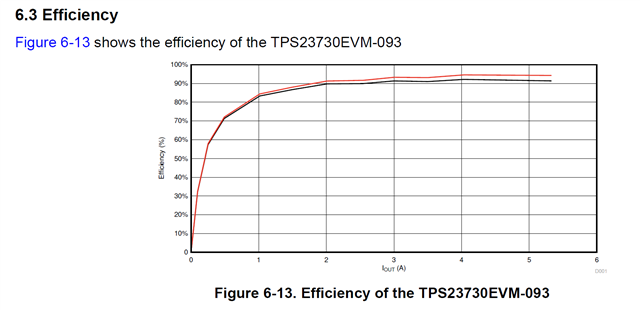

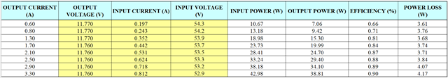

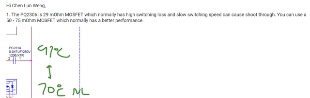

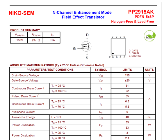

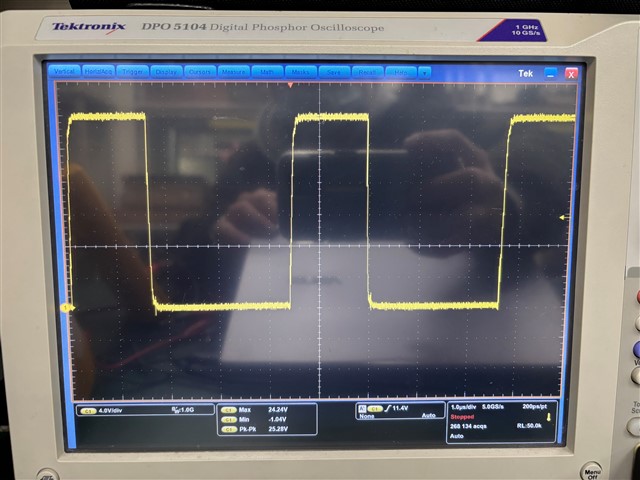

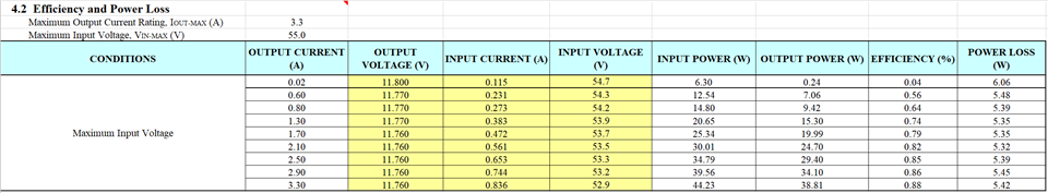

I want to confirm why the efficiency is so low during low load conditions

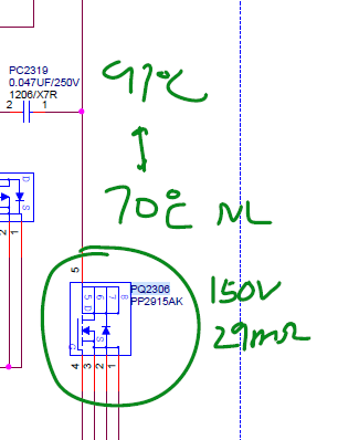

When Vout(+12V_D) no load, the temperature of PQ2306 is 70 °C
When I have load (3.3A) , PQ2306 is 97 °C

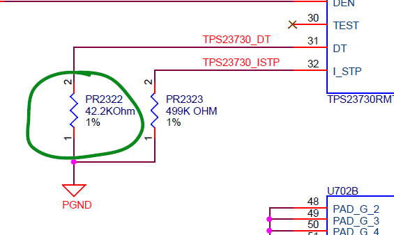

When no load,the measured current through PR2320 is 0.1A
When I have load (3.3A) ,the measured current through PR2320 is 0.8A
How can solve this issue?
