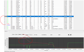

    thank you for fast .c file generation, I have tried this Initiate Swap to Source bit before, but it doesn't work correctly.
    I attach logs with the behavior.
    7433.log.zip
    Would you have any idea how to make it work, please?
    Thank you

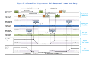

    Due to the nature of PD logs, it is a little unclear which side is which. I'm going to assume that as you said, the far end acts as source. In this case, the TPS25751 begins as UFP Sink
    The "initiate swap to source" setting appears to be working, as we see a PR_SWAP initiated by the sink multiple times (first instance is line 26). The issue is what happens after. Let me explain the expected behavior, and then break down where you might need to debug and address potential issues.
    PR_Swap initiated
    Far end accepts
    Original source removes VBUS
    Sends PSRDY when VUBS is removed
    Original Sink becomes New Source and starts to prepare VBUS by providing 5-V
    New Source sends PSRDY when complete.
    What are you doing with your 5-V and PPHV supplies during the this transition? Are they able to source 5-V at this time?
    The first time, we see that the system makes it past the PR_SWAP case and then attempts to negotiate a high voltage contract, where the voltage immediately drops out. Can you help me understand what you see from the MCU and Voltage programming at this time? Have we provided 5-V to PPHV at this point?
    We see multiple disconnects and reconnects in the remainder of the logs, where we see the system only make it to the finaly ps_rdy. Then the 5-V drops to 4-V? Do you know what could be causing this behavior and where that 4-V is coming from?
