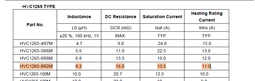

Hi Eric,
Thanks for your reply.
MOSFET's PN is NCEP078N10AK.
Damaged MOSs are lost. But What we can confirm that there is no obvious damage on IC's package.
As for inductor, please see below datasheet.
Hello Gary
8.2uH is not in the attached PDF file, but looks like the saturation current of 8.2uH is ~2.2A, which might be too small.
Please measure the inductor current using a current probe and check if any saturation at hottest ambient temperature.
-EL
