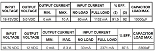

Hi Team
do we have any POL solution which can support below spec?
BRs
Brian
  • Hi Brian,
    The LM70860 or LM70880 can be paired up as a multi-phase solution to provide the output current that is required. The issue will be the output capacitor load. The LM708X0 has internal soft-start of only 2.8ms (typ) which is quite short to charge up output capacitances for both cases. How about a controller?
    Ben
  • Hi Ben
    appreciate your great support here Slight smile
    could you also provide controller solution? it will be good if you can also provide MOS solution.
    BRs
    Brian
  • Hi Brian,
    Please close this thread and open a new thread. Depending on the application, I would try the LM5148, LM5137, or LM5085. Someone on the team can assist you for your controller needs.
