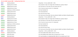

TPS25751: USBC Functional Compliance Test TD 4.5.4 DRP Connect DRP Test fail
Part Number: TPS25751
Hi Team,
I have run TPS25751 device against Ellisys "USB Explorer 350". I got fail on TD 4.5.4 DRP Connect DRP Test. And the fail reason is "PUT must source Vbus after Vbus has entered vSafe0V and before tVbusON expires".
We want to know what kind of firmware configuration will directly affect the test results of TD 4.5.4? Could you help us to pass this test?
Thanks.

    After we modified the PD firmware configuration with ACT, we re-tested TD 4.5.4 and obtained the latest test results. It seems that the two main problems are tVbusOn timeout (greater than 275ms) and Vbus enabling taking too long.
    We would like to ask if you can help us modify the time of tVbusON and enabling VBUS? Because ACT does not open such options for us to change them.
    I provide the configuration below we used to generate the firmware. If possible, please help us confirm whether there are any errors in our settings regarding this test item.

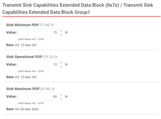

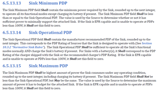

    1- I reviewed the logs provided and made some changes to the json (see attached) that should pass both tests related to Battery capabilities and Battery Status responses TEST.PD.PROT.PORT3.1 and TEST.PD.PROT.PORT3.3.
    See changes below:
    •  Number of batteries field in Tx Source Capabilities register 0x77 should be set to 1.
    • Sink Operational PDP was set to 0W which was causing a failure. See the following descriptions from the USB PD specification.

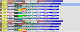

    2- In terms of the VCONN Swap failure, TEST.PD.PROT.SRC.8, I was able to test on my end using a TPS25751EVM with the json and VIF provided on this thread. This test passed on both GRL and Ellisys (I did not test on Lecroy).
    Looking at the logs you provided, it seems that the PD controller is responding the VCONN swap messages with an "Accept" message, meaning that this could be a false tester issue.
    3- Lastly, I am still analyzing the following failure, TD 4.5.4 DRP Connect DRP Test, and will get back to you with more feedback this week.

    TEST.PD.PROT.SRC.8
    After our confirmation, we found that LeCroy tester determined that the reason for VCONN SWAP failure is that it sent multiple VCONN_SWAP messages, and our PD devices almost all responded "Accept" after receiving them but we did not reply to the last one.
    Please refer to the screenshot of my log below. The VCONN_SWAP message of packet 134 seems to have not been responded to. After many tests we still failed here.
    Thanks.
  • Hi Wei-Ting,
    According to the CTS, if the UUT reponds with a Wait message in PD2 mode (in the case here), the tester should resend the VCONN swap message which I do not see happening in the Lecroy logs. I will share GRL logs for reference at the end of the week.
    Are you able to test with Ellisys or GRL?

    In addition, is there any update for the TD 4.5.4 failure?
    Thanks.
    Wei-TIng
  • Hi Wei-Ting,
    I was able to replicate the same failure on my end for TD4.5.4 and it appears to be a known tester issue as well.
    Please let me know if you have additional questions/concerns.
    Aya Khedr
    Ellisys 4.5.4 Test Trace.zip
    The testers we want to waive for TD 4.5.4 is LeCroy M310e and Ellisys ex350.

    For the Ellisys issue, can you share the VIF used? I tried loading the one in the file and it seems incomplete. Which version of VIF Editor are you using?
    Are there any additional test logs that come with the Ellisys report? I tried reviewing the .u31t file in the Ellisys Type-C Tracker Analyzer tool but it just shows a USB 2.0 overview with a reset?
    The Compliance Report.html report provides info on failed tests, but no information on how the tests are run and where it fails. I need more info to debug this one.
    I found some test logs about TD4.5.4, I hope it can be helpful to you.
    Verify_1222_TD 4.5.4.zip

    Do you have the Ellisys Analyzer logs? I am unable to see that from the file shared.
    I am expecting a response tomorrow or early next week. I will keep you updated.
    Aya Khedr
  • Hi Aya,
    Regarding the test trace of TD 4.5.4 Ellisys, we will provide it to you for analysis as soon as possible.

  • Hi Aya,
    We uploaded the latest test trace here.
    Ellisys_4.5.4_Fail_0217.zip
