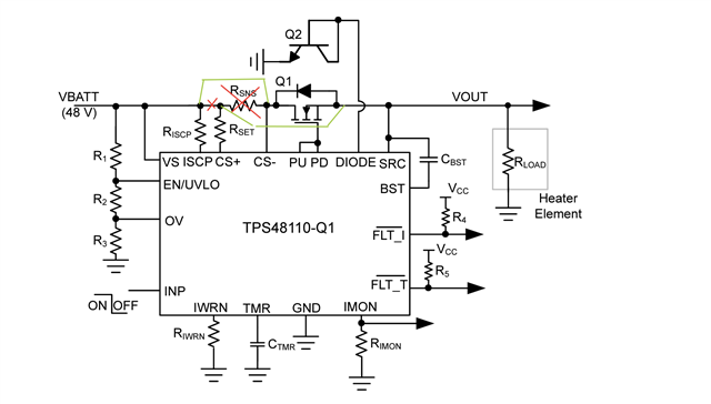

I have inductive loads (blowers) that is why I consider this schematic:
As MOSFET I want to use IAUCN08S7N013ATMA1 1.3 mOhm
The problem I see:
1. Rdson may change dramatically, I have a load maximum 15A. Should I calculate SC trip point for maximum expected resistance (2.5mOhm)? Or for expected maximum working temperature conditions like 2mOhm?
2. RImon output. I want to have some information regarding current, even if it is not accurate. But I see there may be too high voltage up to 6.5V on output especially when fet is opened.
2. What are your general thoughts to use Rdson as current sense? I don't care to buy sense resistor, I just want to save dissipation power.

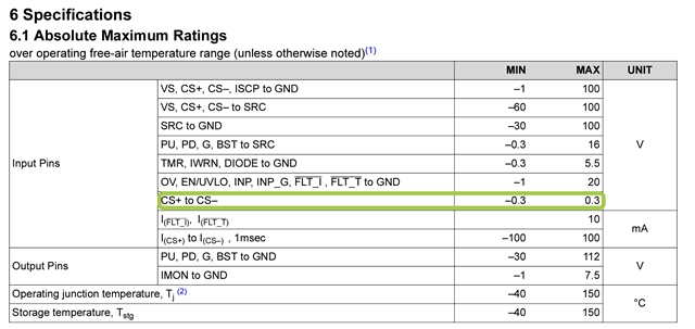

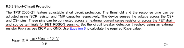

  • Also it is quite strange with RDSON sensing, in absolute max ratings it is claimed 0.3V max CS+ to CS-:
    But if I do RDSON sensing according to 8.3.3 in off state it may be up to 100V between CS+ and CS-
    Something strange here

    This is a known issue in the data sheet, that section mentioning Rdson sensing is from the TPS12000-Q1/TPS48000-Q1 data sheet and was erroneously included. TPS4811(0)-Q1 can't support Rdson sensing. But you can use a small CS resistor instead to save the power dissipation and have a more accurate ISCP threshold, or use TPS4800-Q1.
    Patrick
