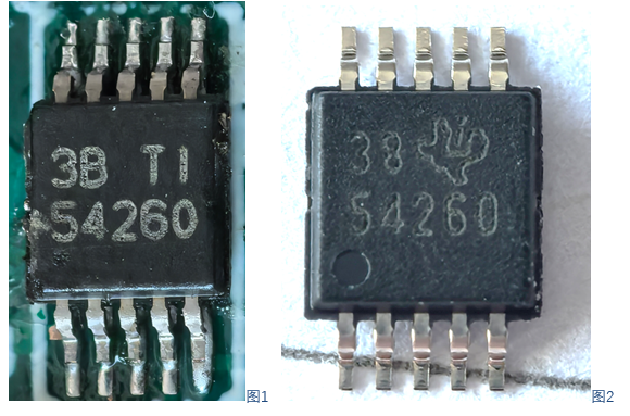

Recently Delta reported that  some TPS54260DGQR (the left) can work well,  but some IC not (the right) which is from TI sample stock,  Label as following.

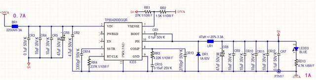

Delta's schematic as following:
Inverting application:   Input:  22V~ 26V,   output: -15V/ 1A,  more information in the attached EXCEL.

    Can you support the following questions firstly:
    Q1:  Help check the parameter in Delta's schematic is reasonable based on their application (In Excel document.)
    Q2:  What's the difference the following two top mark IC?

    I have one comment their schematic. compensation components need improvement. Rcomp(RR3) value is bit small and Chf(CR13) looks pretty big. They can use values suggested by the quickstart calculator. Rest of the schematic looks fine to me.
    Two ICs shown in picture are sourced from different assembly sites but functionally, both are same. To get more information about the ICs, could you please share the lot no. or label for the left one.

    Delta changed RR3/ CR13 based on the values from our calculator tool, but this problem can't be fixed.

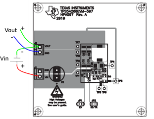

    Do you have a TPS54260 Inverting power EVM to repeat this issue?

    TPS54260 EVM (TPS54260EVM-597) can configured in the following way to make it inverting buck boost.
     I'll provide you my suggestions for testing on Monday. As I am out the office today.
