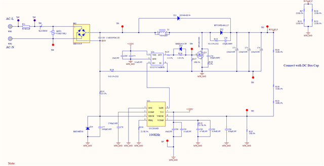

I used UCC28180D and gate driver UCC27517ADBVR to design a PFC and output is 390V following the design reference 900W TIDA-00443 for our 230V motor drive project. The load is BLDC pump, max power is around 650W. The output voltage is around 393V. After running the pump for about 10 minutes, the current resistor 20m ohm burnout. check the Mosfet is bad( D, G, and S all short together). The fuse and bridge are both good. The gate driver is bad( the 15V and GND short together). What i believed is that the mosfet is short and the current is too large and burned out the current sensing resistor and some of the trace. The question is what caused the gate driver short the VCC and GND? please provide some help.

  • Hi Ulrich,
    thanks for your prompt reply. There is a big aluminum casting on the back and the MOSFET is attaching to this aluminum casting with a thermal pad. There is also a fan powered by the motor and blows the air to the aluminum casting. I will focus on the heat performance of the MOSFET. Below is the the schematic, please help check. thanks The load is BLDC.
  • Hi Huangsong,
    Thanks for the schematic diagram.
    Also check into the output diode D22 temperature rise and reverse recovery current.
    Although it is an ultrafast part, it may be getting too hot and increasing Irr more than the MOSFET can handle.
    at 100kHz frequency, consider using a SiC diode in this position.
    Aside from that check to see if gate-drive diode D23 can handle the peak turn-off current going through it.
    Although if it fails short or open, I don't see how it could cause the MOSFET to fail.
    (Note: precision resistors are not really needed at R125, R126 and R127.)
    Ulrich
