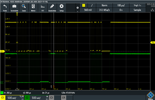

We are working on BQ27Z561-R2 battery pack project. Battery pack with gauge inside and that solution is connected in to the system. After testing prototype in greater quantities we noticed that after some random time communication with gauge fails.  We are now in the process of hunting down the problem. After probing I2C line we noticed strange behavior.  When communicating with other system I2C devices that phenomenon is not present and I2C waveform looks normal. STM32 communication with BQ27Z561-R2 gauge looks like shown in screen grab below.
SDA line sometimes does not reach 0V

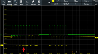

 Tried to use I2C line buffer FXMA2102 but that just amplifies the problem and communication failure occurs more often. Screen with FXMA2102 used, signal on the gauge side of the buffer:

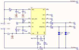

Pack side gauge schematic is very basic and mimics the evaluation board

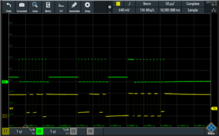

    Communication to other devices looks normal, communication to battery gauge has those raised logic low levels. Looking in to communication structure I see that SDA 9 bit , CLK stretch period are raised. Also SDA last word (after second stretch period) is raised from start to finish. Is this a sign that battery gauge is not able to sink the commination lines ?   I was not able to find recommendations for pull up resistors in the documentation. Maybe you can suggest?
    I replaced 100R series resistors which were suggested in gauge reference design for EMI protection. Replaced with 0R ant that helped slightly, the intermediate low level is now closer to zero.

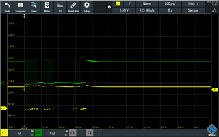

    I tried replacing pull up resistors to 10kR and the intermediate logic Low level become even smaller, almost negligible. For me this only adds to assumption that problem is in BQ27Z561-R2 that it has very limited pull down capabilities and can sink not enough current. Maybe this is particulary true with 1,8V mommunication voltage.
