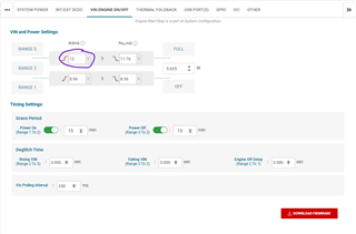

TPS25762-Q1: Configuration settings not charging device on port A (TPS25762Q1evm-146)
Part Number: TPS25762-Q1
Other Parts Discussed in Thread: TPS25762C-Q1
Ive tried an array of different configuration setting to try to get multiple PDPs/PDOs for a Port A charging output using the F311_03_11_0001_release files without any success. I use the 03_11...bin as the base image and add my gui settings, and uploading to the EEPROM. After reset, i dont see any charging and i'm thinking theres some configuration issue that i'm missing. I read through the evm datasheet and the Gui datasheet, and still havent had any luck. Any guidance would be great!
