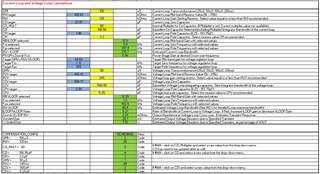

Can you help review my customer's excel calculator file and schematics attached below ?
we would like to check if any where we can improve the phase marging and gain margin, and also improve the output ripple. thanks !

Hi PYTSai
This is already answered in the email, is this module stacked ? or are the rails different for 2 different Vouts?
The excel calculator you attached is what I have sent to customer over email
here is my updated excel , with one setting that can help achieve required spec
1. increase the frequency to 650kHz
2. Increase the Cout to 2000uF
3.2 ways to adjust compensation
a) pinstrap compensation setting can only do so much from the available options but
b) compensation can be adjusted with PMBus and can be stored to NVM to achieve required transient , ripple, phase margin
below shown section can help you with PMBus compensation code
compensation config : 12 C4 82 65 02 (Hex value)
4. MSEL1 resistors to R1230: 38.3kohm and R1235:68.1kohm
5. if application is not stacked and bothe rails have same spec you can use the above mentioned for the other rail

Hi Savith
For the design case where the rails are different for two different Vouts, another path will follow this configuration as well.
=> MSEL1 resistors should be set to R1230: 38.3 kΩ and R1235: 68.1 kΩ.
For the register configuration, could you send me the corrected firmware loaded file?
By the way, could you share the protection password for that Excel file?

Hi Jackrose,
But if it helps Attached is the csv file I created to best of my knowledge from Power Fusion GUI Version 7.10.1
Thank you
Savith
Hi Savith
Thank you for confirming the resistors for both paths.
Regarding Excel, I am seeking the optimal configuration that works with our hardware design to achieve a sufficient phase margin, with the aim of maximizing mitigation/avoid the interference for RF performance.
Is the CSV configuration you provided optimized for our hardware design?

Hi Jackrose
1. current excel tab device calculator cells C166 to C168 shows phase margin 42.7kHz, bandwidth 56.5 degrees, Gain margin12.8dB, you can adjust the compensation settings using PMBus with rows 122 to 152 and use the hex code from cell F155 and the CSV is generated with the above loop response
2. As said earlier you can also use pin strap MSel1 to adjust the compensation using rows 66 to 111
