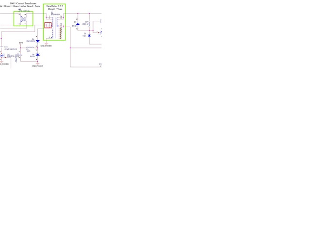

    Attached is the updated schematic (corrected T2)
    1. What is the primary side OUT pin duty cycle at 10.5A load current and at what input voltage?
    ------- primary duty cycle: 42%, input voltage: 12V
    2. What is the OUT-pin duty cycle when Vout is 12V, and how high the current can be carried when Vout keeps 12V, at what input voltage?
    ------- Not sure which pin the OUT-pin refers to, I measured PIN4,5 & PIN14,15 This experiment input voltage: 12V, T2 I(RATED) max 15A, Load: 15A, Vout can Keeps at 12V PIN4,5 - duty cycle: 31% PIN14,15 - duty cycle: 58%
    3. What is T2 turns ratios specification? -
    ------ Turn Ratio: 3:7:7

    At this condition, when you increase the load current to be larger than 10.5A, say 15 A, what is the duty cycle measured on U2 pin 15 (OUT pin)?
    2.
    U2 pin 15 is OUT pin
    So at 12V input, when the load current = 15A, U2 pin 15 (OUT pin) duty cycle = 58%, right? What is the output voltage Vout, is it still 12V?
    ------- Load 15A,U2 PIN15 duty cycle = 65%
           2.U2 pin 15 is OUT pin
    So at 12V input, when the load current = 15A, U2 pin 15 (OUT pin) duty cycle = 58%, right? --- No,58% is T2 PIN14,15
    ------- 12V input,Load 15A,U2 PIN15 duty cycle = 65%.
              Yes, Vout is still 12V.
    Back to your original question red underlined, what was the condition, input voltage, output voltage and output current, it sounds not consistent to your latest reply.

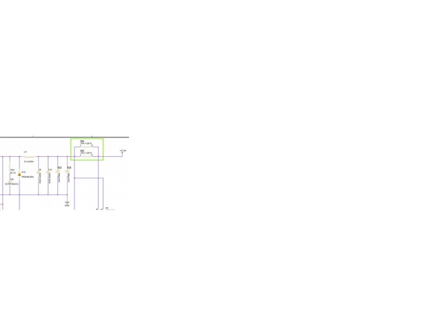

    R63 & R64 are originally 20m, with a maximum current of 10.5A After changing to 10m, the current can be 15A
    It sounds like no problem to you now.

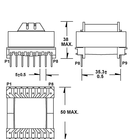

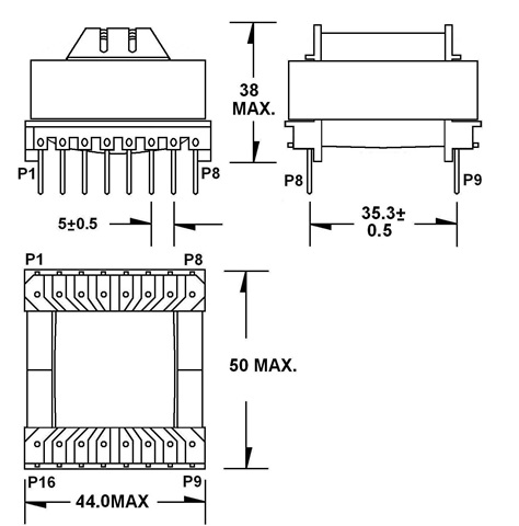

    If you want to output 24V/8.5A
    1. Can we calculate the number of turns and inductance of each transformer according to the attached transformer dimensions, and then ask the manufacturer to wind the sample according to this value?
    2. In addition to replacing the transformer, what other parts values ​​need to be changed?
    You need to talk to your transformer vendor or builder to find out. Usually, the transformer number of turns also need to consider the core material (for example Bmax, etc) and other things, so your transformer builder would need to know if the number of turns are good, and also if the bobbin and the core you selected are ok to fit in that many of turns with sufficient wire gage. So not a simple process.
