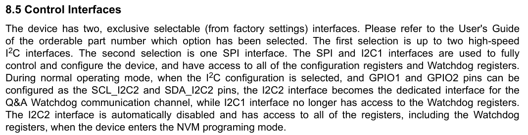

    So you are able to read page 3, in fact if the base I2C address is 0x48, Page 3 is located on 0x4B. What you're referring to as 0x12 or 12h is Page 4 which is the WD registers. If GPIO1 & GPIO2 are selected as SCL_I2C2 & SDA_I2C2, respectively the address will respond there for Page4.
    On page154 of the datasheet we have the following. If you're trying to readback the registers without going into the NVM programming mode, then it is understandable that you would not be able to read Page 4 (I2C2 address of 0x12)

    • Only registers 0x05 & 0x09 can be written to for the Watchdog registers
    • The registers for the watchdog will be accessible on I2C1 with all other register writes, if you're writing to I2C2 (GPIO1 & GPIO2 configured for I2C2), you will not see the registers on this interface. You can confirm this by asking for readback on the I2C1 interface before any of the serial interface changes. After making the changes to the serial interface, please allow for some time to elapse before access the rest of the register pages to ensure that NACKs are not from instant sequential writes.
