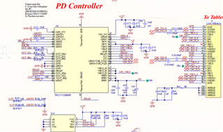

I am designing a USB-PD controller with the TPS25750 (see attached schematic and json) and are currently testing the hardware.
Note:
USB_VBUS_U is connected to USB_VBUS
UPC_CC1 is Connected to UPC_CC1_SW
UPC_CC2 is Connected to UPC_CC2_SW
ADCIN1 is strapped to LDO_3V3
ADCIN2 is strapped to GND
I cannot see where the TPS25750 is reading the EEPROM:
All the input rails are correct.
All the output rails are correct.
The TPS25750 is outputting 9V but does not indicate Fast Charging in the POWERZ or the AVHzY-CT3.
Neither of the CC1 or CC2 seem to have any voltage on them.
Json works fine on the TPS25750EVM.
I do not currently have access to the I2C on the TPS25750@ pins 8, 9, 10.
I am sure I am missing something but I cannot see it.
Thoughts?
Rick
https://www.dropbox.com/scl/fi/ybdv58kge90wlxqsegxck/config-12-11-24.json?rlkey=hzju4cbp0pupx3q34jo338ovt&dl=0
https://www.dropbox.com/scl/fi/q15eq038yznaf5fphwrjm/PD-SCH.pdf?rlkey=vbcm8ll3tnp3dqrz8ilttalk9&dl=0

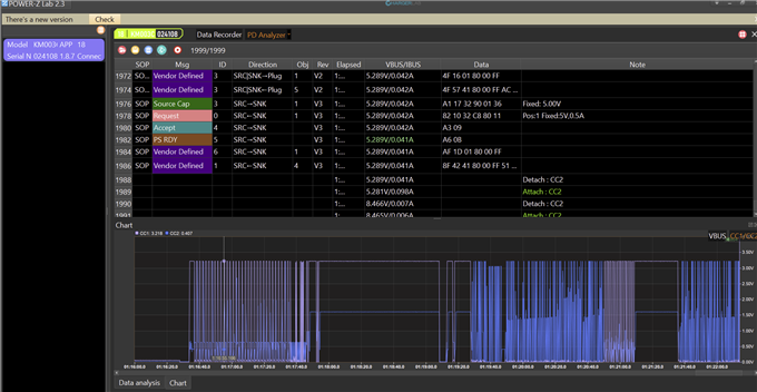

  • After looking at the Power-Z's User Manual, it supports multiple types of "Fast Charging". If you are getting 9V on VBUS, then you are successfully getting a 9V USB-PD contract. You can use the Power-Z in pass-through mode and capture the USB-PD logs on your computer to see if the traffic matches what you're expecting.
    Conner
  • Hi Connor,
    While I am getting 9V supplied via USB, the Power-Z is indicating NO USB-PD contracts.
    I don't think and can record no evidence that the TPS25750 is reading the EEPROM at power up.
    Suggestions?
    Rick
  • Are you able to look at the I2Cc lines? Those are the ones connected to the EEPROM, not pins 8, 9, and 10 (which are the I2Ct lines).
    Additionally, were you able to use the Power-Z in pass-through mode to log the PD traffic?
    There is also the potential that the 1k pullups are an issue.

    WRT your I2C pull ups need to be at least 2.2k ohm. I would also recommend tying the I2C lines to LDO_3V3 instead of VIN_3V3.
    I have made the suggested changes and see I2C traffic in the I2C bus pins 16 and 17.
    The CC levels don't seem correct.
  • As far as the CC lines, when the PowerZ is behaving as a sink (as opposed to being in pass through mode), the HID plug should be unplugged and the USB-C female plug should be the only port used, then you would hold down the "Right" button (7) to turn on the device as a sink and select "Keep CC pull down resistor" to test USB-PD protocol. There are detailed instructions here: https://www.chargerlab.com/inventory-of-10-commonly-used-functions-of-power-z-km003c/
    If you're using the Power-Z as a pass through device, let me know the device you're using as a sink, and include the log, and I will provide feedback.
    Conner
  • Hi Conner,
    Here is some data collected
  • Hi Rick,
    Conner is currently out of office. Please expect some delay in responses.
    Aya Khedr
  • Without knowing which device is behaving as a sink, which device is behaving as a source, and who the TPS25750's port partner is, this look like one of the port partners is experiencing UVP or OCP and causing the disconnect.
    Would you be able to provide the aforementioned information?
    Conner
  • Hi Conner,
    TPS25750 is a DRP being supplied with +9V external supply or drawing power from a Samsung tablet.
    The TPS25750 seems to be fine in sink mode.
    But when switching to the source mode with +9V supplied the CC1 line is 0V and the CC2 line is toggling about.
    No PD protocol is recognized but the tablet is charging at 8V@.44A 3.6W expecting 13+W from eval board

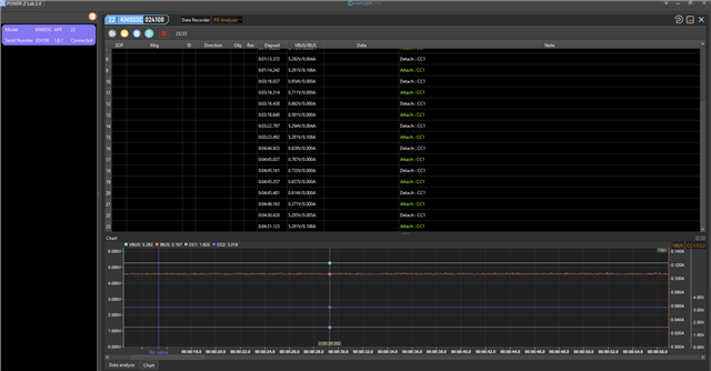

  • Hi Conner,
    I did this:
    The HID plug should be unplugged and the USB-C female plug should be the only port used, then you would hold down the "Right" button (7) to turn on the device as a sink and select "Keep CC pull down resistor" to test USB-PD protocol.
    results were Unattached when testing PD only and NO Fast Charging Found when testing all protocols
    rick

    Made some progress but new design does not respond as PD3.0 see comparisons below
    CC pics.pdf
    Rick
  • Can you tie the ADCIN pins to LDO_3V3 instead of VIN_3V3? And can you do the same with the EEPROM VCC pin? I think the configuration might not be loading properly at boot due to the difference in timing between the two rails.
    Conner

  • Hi Conner,
    I think I see the problem.
    The Vbus is at 9V while trying to connect. see doc below
    CC lines 2-10-25.docx
    The PD ends up in Attach.Wait.Src waiting for "Vbus at vSafe0V and sink" per USB-C Dual Role Power Connection State Machine.
    Is there a setting to force Vusb to be 0V during connect?
    Rick
