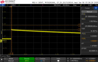

Hello Team,
We are using part->LM5150QRUMRQ1 in our design.
When the load is not connected at Output of Boost Converter. The boost operation is happening, But as soon as we connect the load-0.150A, the boost operation is not happening
After application of load current, AVCC voltage is also decaying and is not fixed at 5V.
Can you please support on debugging this issue?
Attached are schematics of this IC and other waveform captures
Sumit
LM5150Q_Boost_Schematics.pdf
Boost Output Without Load
Boost Output with Load
AVCC Without Load
AVCC With load
Boost Switching

  • Hello Niklas,
    Below are asked details->
    Vin- 3V-4.2V
    Vout-6.8V
    Iload-150-200mA
  • Hello Sumit,
    There are two things to look at:
    - If the green signal in the oscilloscope screenshot is the Boost_EN signal in the schematic, you can see that the controller is periodically disabled / enabled.
    Can you permanently connect the EN pin to VOUT, to see if that works?
    - I would also ask you to verify if the supply can really deliver the peak current that is necessary to charge the intuctor.
    This peak current is much higher than the average load current and the supply must not limit it.
    Best regards

  • Hello Harry,
    Yes the Green Signal is ENABLE signal and the voltage level is HIGH enough to be detected as HIGH and I have zoomed and checked in oscilloscope, there are no transitions in the signal
    Regarding your 2nd point, I have connected input of boost to external power supply set to 3.8V- Supply is capable of giving 30V, 30A max. So there is no issue with sourcing capability of powersupply
  • Hello Sumit,
    The device will not properly start-up when you just supply 3.8V.
    See page 7 of the datasheet:
    (2) The device requires minimum 5V at VOUT pin to start up
    You will need to supply more than 5V first. When it already boosts, you can reduce the input voltage to 3.8V
    What is that noise in the green signal in the second image?
    In the working condition in image 1 it does not exist.
    For further tests, please disconnect that voltage monitor and permanently connect the EN signal to a high enou8gh voltage (e.g. VOUT).
    Best regards
    Harry
