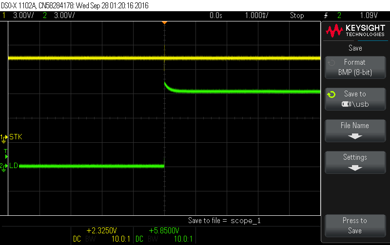

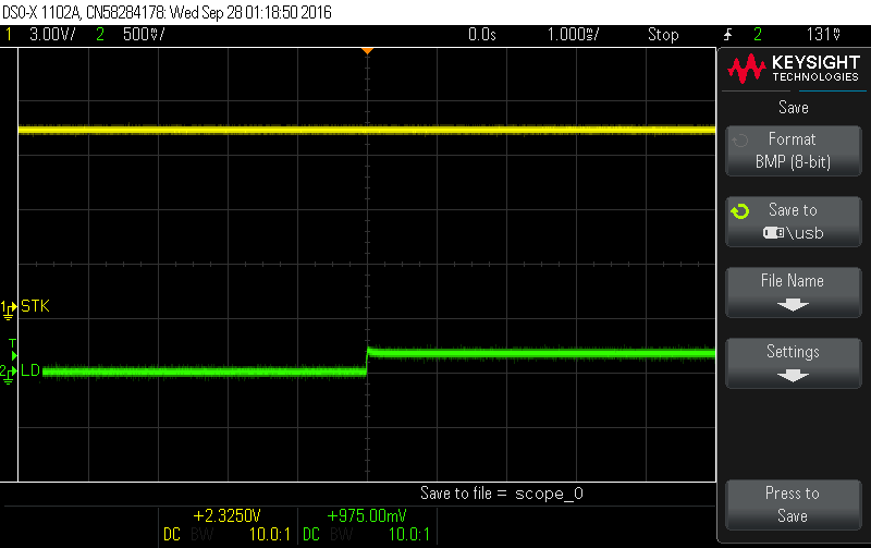

  • Hi Alexis,
    Here are the screenshots:
    With PREDISCHARGE Enabled  (500 mV by division)
    Wit PREDISCHARGE
    WITHOUT Predischarrge (5 V by division)
    I'm going to try to use Stop Delta parameter,  what value for it you can suggest?
  • Hello Vadim,
    I would not say that PREDISCHARGE mode is not needed when using parallel paths.
    PREDISCHARGE mode’s function is mainly to reduce inrush current when the load is initially powered. This can help prevent the AFE from perceiving and prematurely triggering a SCD fault. The pre-discharge path also helps avoid capacitive current spikes when the load is attached.
    This Parallel Paths with the BQ769x2 Battery Monitor Family application note may also be useful to refer too.
    As for a stop delta value, this would depend on what you would prefer for your system.
    Alexis

    The only issue is that i've exepected the LD Voltage gradually go from 0.04 V to 9.8 V but i did not observer it.
    At the moment when DFETOFF SWITCHEDto 0 the LD Voltage jumped to  0.210 V  and stayed there until the timeout

  • Hi Alexis,
    I'm using for my tests BQ76952EVM with 4 LFP Cells, connected as recommended in the users guide when VC3 is shorted to VC15. with and without 100 Ohm load
    I'm attaching a file describing the tests in detail and associated scope screenshots.

  • Hello Vadim,
    Thank you for sharing all of those results and information! If you did not change anything on the BQ76952 EVM near the PDSG FET, that would explain why you are seeing the LD voltage stop at ~0.32V.
    R40 (4.7kOhms) on the EVM schematic forms a voltage divider with the load resistance you have of 100 ohms. This stops the LD voltage at ~0.32V when you have the PFET enabled. You can have the LD voltage increase to something higher by changing that resistance to something smaller.
    As for why the PDSG STOP DELTA hasn’t allowed the DSG FET to be enabled is for a similar reason. With the PDSG STOP DELTA, the LD pin voltage needs to be greater than or equal to the top of stack voltage minus the delta chosen. Since the LD voltage could never go higher than ~0.32V, the device would not exit PREDISCHARGE mode.
