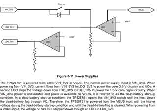

    The VIN_3V3 is about 2.7V, also the LDO_3V3 (it should be powered from VBUS in that case and be at 3.3V?).
    During this scenario, is the system powered on through the battery or through the Type-C connection with a source? If TPS25751 VIN_3V3 is not at a stable 3.3V (2.7V as you described), it may put the PD in an abnormal state of not being able to boot-up. It looks like the VIN_3V3 source is from UBAT0 connected to BAT of BQ25792, is that correct?
    In the data sheet BQ I saw a lower batttery limit of 5V. Does it mean dead battery charging does not work below 5V?
    I'll loop in the BQ team for further support on this query. From TPS25751 perspective, the PD can powered on either through VIN_3V3 (3.3V) or its VBUS pin. If TPS25751 is first booted from VBUS, the PD internal power topology will use VBUS as the primary power source until the dead battery flag is cleared. See screenshot from TPS25751 datasheet below:

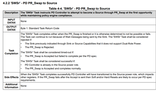

    The procedure is the following: the part is in sleep mode and and VIN_3V3 and 5V  is witched off. Then I connect the smartphone which makes the TPS going to sink mode (and dead battery mode, probably also a reboot from EPROM). Then I switch on the power supply of the TPS (VIN_3V3 and 5V after some seconds) and send a DBfg command. --> Nothing happens.
    The DBfg command only clears the dead battery flag, it does not initiate a power role swap with the connected port partner. After you send DBfg, you'll need to instruct TPS25751 to send a PR_Swap request with the connected port partner using 4CC command "SWSr" (Swap to Source):

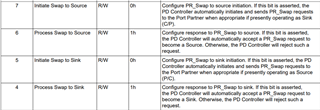

    2. Can I prevent the TPS25751 from starting a sink or source mode during my sleep mode? i.e. avoiding the dead battery mode?
    In Port Control (0x29), there are two register fields if you desire the TPS25751 to automatically swap to source/sink. See screenshot below for bitfield7 and 5:
